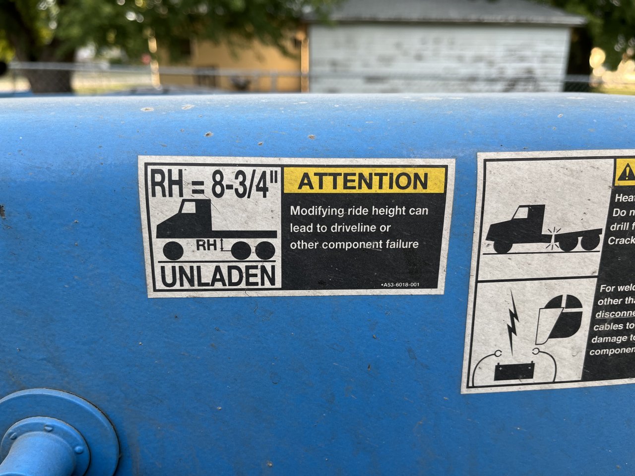

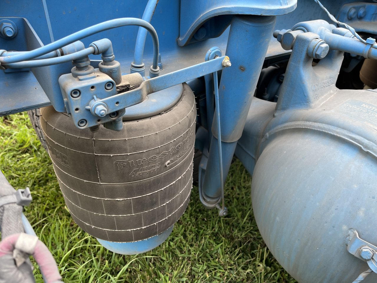

    C8CAFB9F-2ED8-4AF8-9B6D-271B0CEFB9C7.jpeg 39E1C9EC-F097-409F-8002-C662BDD39A66.jpeg
    Ride height isn’t something you just eyeball until you think it looks good. And that rod from the valve to the axle is the only way to change it. Hopefully shifting the blame onto someone else will work for you. It would suck to end up in court if the shop tells you to pound sand.

    What suspension is that one? I'm thinking 8-3/4" is the measurement you want unladen on an AG380 but can't remember 100% for sure. But just like that sticker shows you measure it from the bottom of the frame rail to the centerline of the axle. Also the centerline of the axle is not where the axle tube has bead welded. Don't measure to the center of that weld or it will be off because the rear pinion is angled upwards. Just loosen a couple of bolts, or maybe 3, and clock the level valve to the left or the right whichever way is needed to raise or lower airbags to 8-3/4" then tighten back up. On flat level ground...

    The valve is a Hadley 500 with air dump, the bags are Firestone 8536 or 8537.
    pretty universal for trucks unless it is a HD axle setup.
