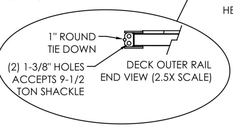

Called round bar tie down, working with factory on new trailer. Deck will be 6” thick, flange will be to thick for chain slots, don’t want to loop chain around bar and back to itself, hard to get binder close to deck if needed, plus they come un hooked when trying to hook up.
Maybe weld plate to beam then bent D ring?
Looking for ideas to pass along to engineers designing trailer. Trailer will have a 10” ride height.
Anybody familiar with this tie down?

Consider 7/16 grade 100 pull ups every 16 inches or every 2nd or 3rd crossmember boxed to outside rail and crossmember.
You can also redirect from the roundbar to another pull up if needed.stwik, clausland, Darpen and 1 other person Thank this. -
D rings diffently. Here is a idea i have tought of, recessed D rings, may require a little engineering.

The securement bar is handy but a bit of a PITA to feed hooks a chains through. Especially if the load overhangs the deck.TripleSix Thanks this. -
I would get some good quality slip hooks with latches for one end of your chains. Maybe even a few for one end of your ratchet binders if you need to hook directly to the tiebar.
Received this today, by putting holes in the gusset holding the round bar I could use a clevis if needed, but I would also like chain drops or d rings in the floor.

Man...I don't care for the looks of that bar at all. Just my opinion, but it looks like your chains/binders are able to slide a little ways along it.

Worked with engineering and will be able to put chain in the deck, it’s 3/4 inch plate but a 1/2 inch long link chain will work.
