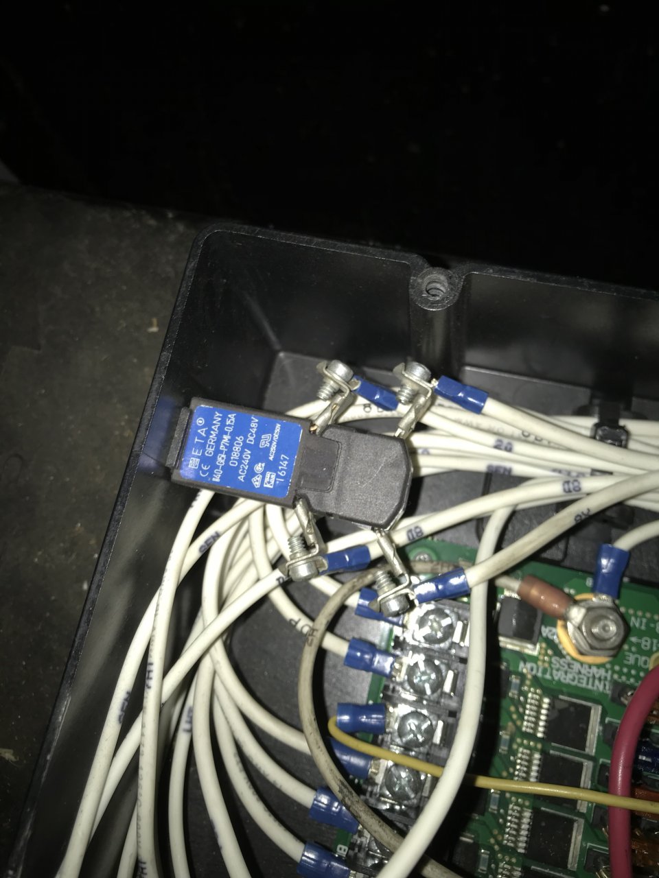

    I'm installing an older tripac around. 2006 . I'm looking for someone with the same that don't care to look in there control box and tell me where 5 wires go . The first is 7x , it's a jumper one end goes on 7x the other I don't know about . I also need to know the position of the 4 wires on the reset switch . Thanks in advance

    FE42C5E9-7FFE-4773-BE36-E7D94B5CDDD7.jpeg B3F16321-E24E-4FA5-97F0-1BBF2AD12FD2.jpeg Not going to be any help with 7x wire. On this one 7x has two wires neither one is a jumper,they both go out to wiring harness. One label “fht” the other no markings.

    For the reset switch. One side has 8d to front leg 8x to back other side has 20 to front leg 8 to back

    This is the switch, the 2 top legs can be seen. Can you tell me which wires go on these 2?

    On the pic you posted,8d would be on the left,20 on the right.

    Thank you , that is what I needed.
    Maybe someone else will have the same wiring setup as me . 7x on mine is a jumper , I don't have any other wires or post marked 7x .
