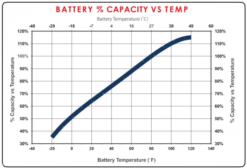

    I keep it running like 1/2 the night below 10'F. I dont really know. I'm my mind. Batteries get colder they lose power. So really cold weather means batteries have 50% of their power? That plus a cold engine means it might not start back up. Then your screwed. But in the mid west that doesn't happen often. I also have a generator in the headache rack and a good battery charger on the truck.

  8. RustyBolt
