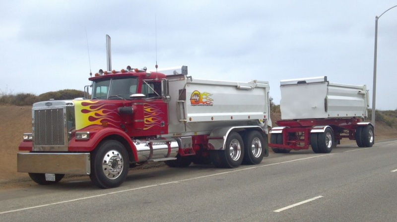

    1986 Autocar Transfer at the beach.jpg Here is a pic of my truck! This is an '86 AT64f with This is the last of a 3406 & 13 speed. This is the Best model A-CAR! By the way this truck is still in service!

    Very nice, I see many around DC pole trucks but mostly Late model units pulling belly dumps here in ND & MT

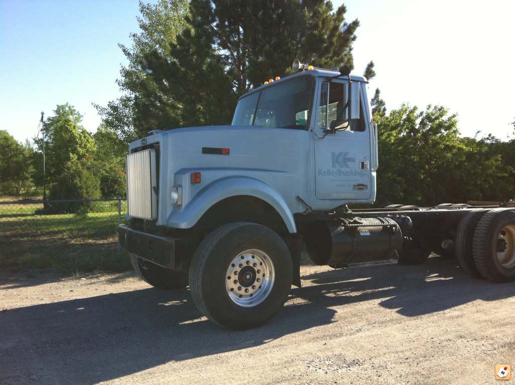

    So I finally got my new toy home with an interesting 780 mile drive from Denver - Belgrade MT, I really didn't pay much attention to a strange looking horizontal canister mounted behind the fuel tank, latter I realized its a Luberfiner 750 an auxiliary bypass
    Oil filter, this means that the oil capacity is increased by up to 3 gals' that would explain where most of my oil disappeared too ,,,!!!
    The rest via what I believe to be worn blower seals, which is known issue with 92 Series DD, also it had partially blocked intake plenum vent valves, these are what gives the DD the name "driptroit " as they are designed to bypass any collected oil between the blower and the intake / liner valley, they feature a pressure regulated spring which will close at a positive pressure, but relief any collect oil at idle / low rpm, these will later be routed to catch tanks, rather than on the road.
    I noticed my low oil level in Casper WY, with no hope of finding Delo 100 40WT on a Sat' afternoon I was forced to run top off with 15w/40 Delo 400
    Truck runs good and this trip has helped me identify what needs to be done
    PS pump & steering box rebuild
    Hendrickson RS suspension bushing rebuild
    Air compressor
    Front hub seals / check brgs
    The tractor is light when going through WY scale
    Ft ax 9420lbs
    Rr tan 6500 lbs
    this is on 200" WB with 3/8" deep section type frame.
    On my last trip home I had to wait 3 days for 12 gals of Delo 100, serviced the Luberfine, stripped out the basic interior, installed a nice 18" steering wheel.
