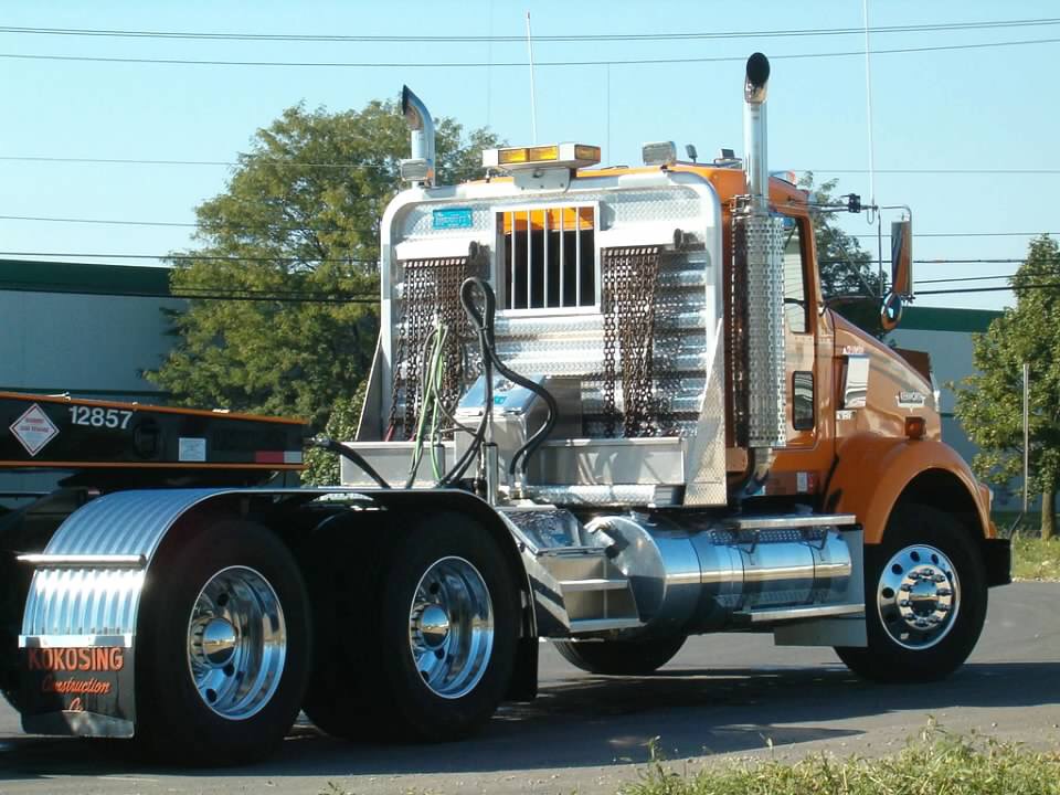

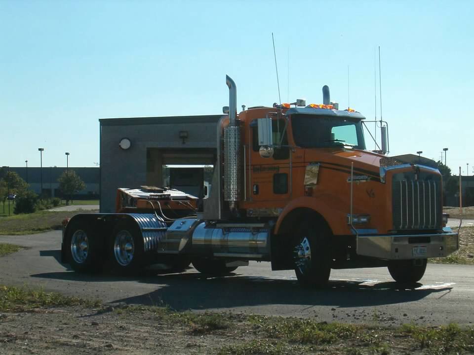

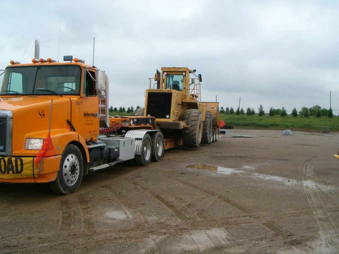

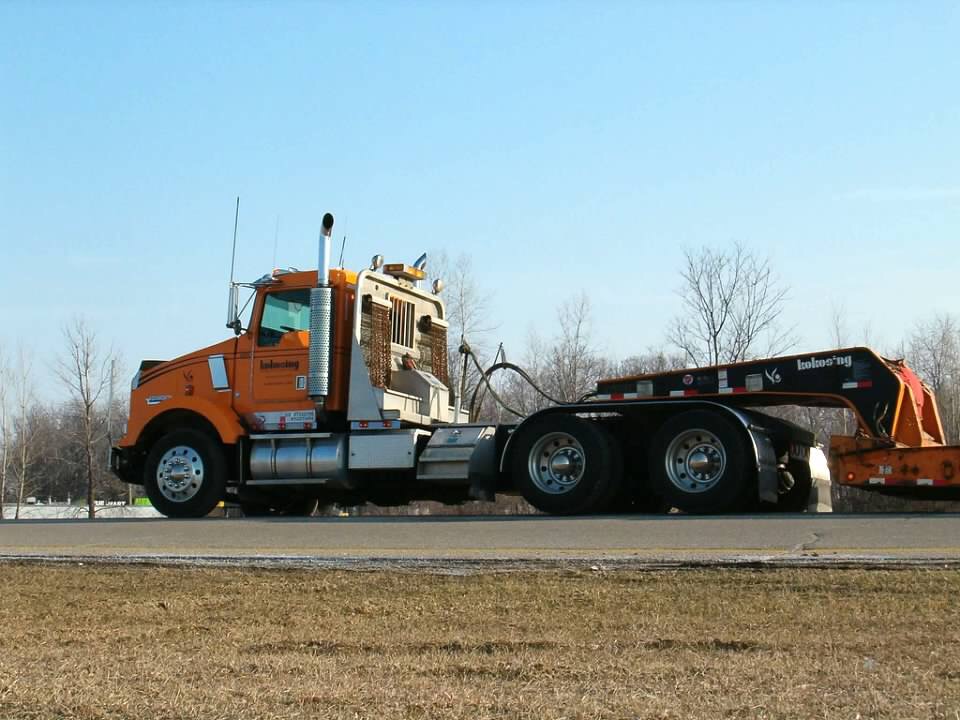

  9. johndeere4020
    8,522
    119,296
    Jan 1, 2010
    I’ve got a bunch of pictures of it, that was my favorite truck I ever drove. I had two of them virtually identical just 5 years age difference.
    Here it was when I picked it up,
    At the truck wash.
    Couple loads.
    Here’s the older one.
