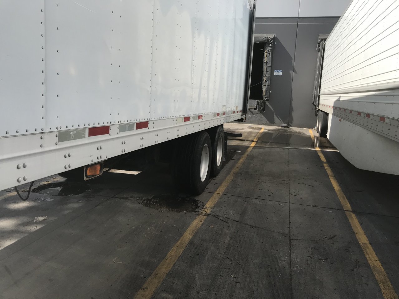

    Got sent to a ratty shipper with a water-filled pot hole right in front of the dock door.

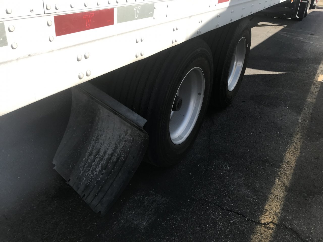

    Backing into the dock, the mudflap got torn off and the hanger bent. I flipped the mudflap around and drilled new holes in it, remounted it. But it looks real ugly, mudflap hanging is dragging on the ground...probably cause me to get an violation if the wrong officer notices it.
    Any advice on how to bend that hanger back into place?

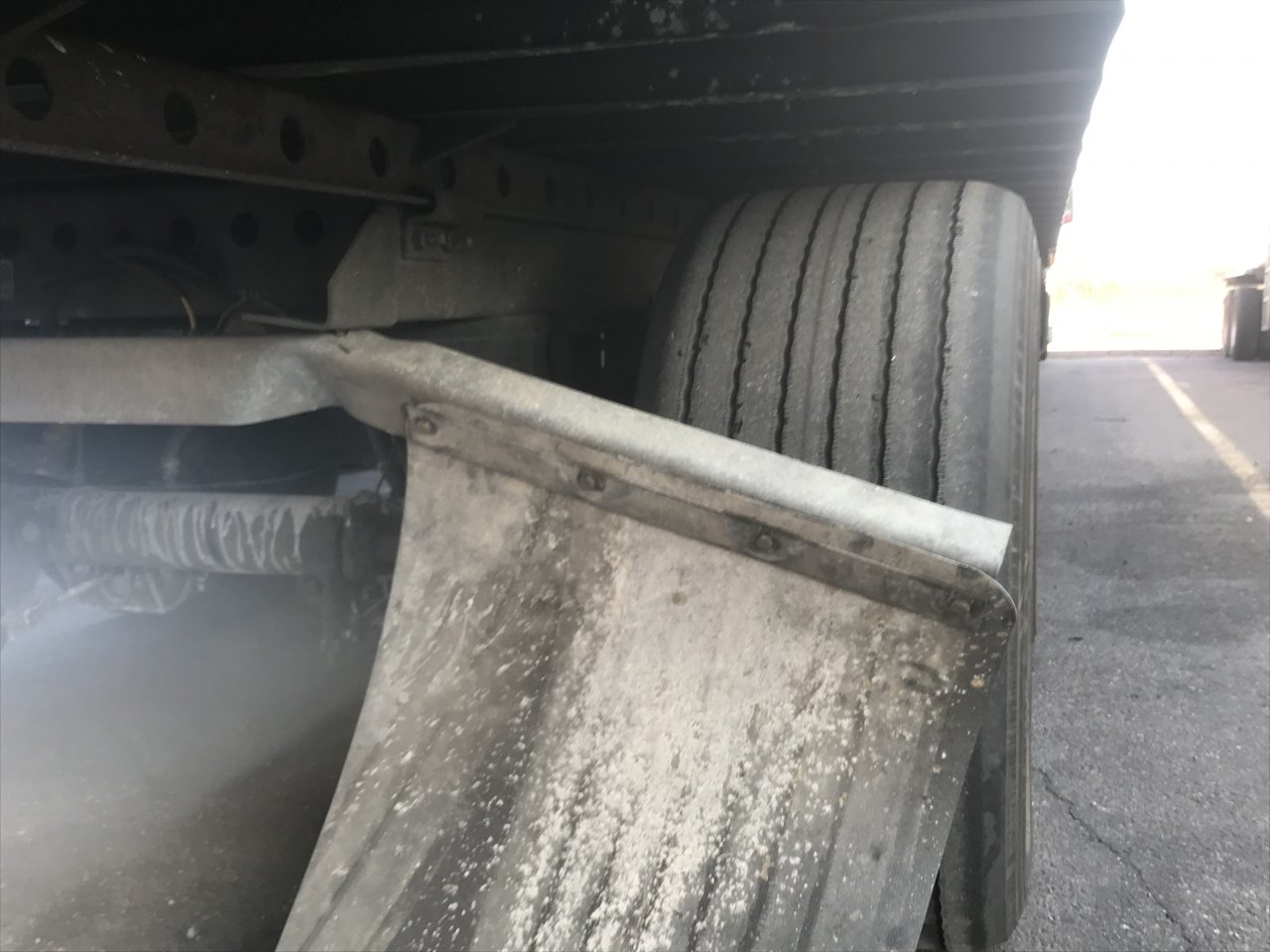

  7. Harry Flashman
    Harry Flashman Medium Load Member
    506
    1,329
    Oct 4, 2019
    Thank you for the replies.
    Here is the hanger.
    D.Tibbitt Thanks this.
  8. D.Tibbitt
    19,660
    130,560
    Dang that is in a tough spot. Looks like u will have to pull upwards... guess if u just wanna get dot off ur back , just cut the bottom of the mudflap off so its not touching the ground. Leave a couple inches of clearence. They will write u up for dragging mudflap.
