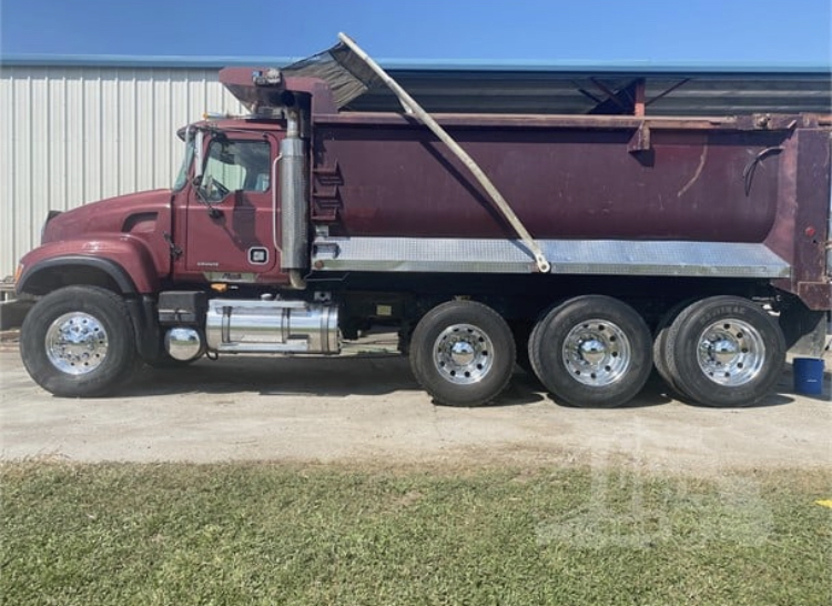

    1747F438-886E-41C1-921E-67EAE0A38C7D.jpeg This is what I’m assuming he means by a tri axle. Maybe this is considered a tandem with a lift axle. I admit I’m not up to date on dump truck terminology.

    Mack has a fantastic reputation in the dump truck industry for producing a sturdy truck. As far as the bed it kind of depends on what you will be hauling. A steel bed will be able to take a lot of abuse if you’re going to be hauling tear out and rip-rap, but is going to be heavy. An aluminum bed will weigh less, and would be perfect for rock sand and asphalt. Also, if you’re going to be asphalting, buy stock in mudflaps. They like to get chewed up by the buggy. @REO6205 is my go to for anything dump truck related. He’s always got great advice. Best of luck!

    Does the lift axle also have to steer in your area?

    No, he said just a basic tri axle was the best thing for what they did.

    Asphalt pays well. FYI, the pic you posted is a good set-up, 20K lb steer axle rating 34k on the tandems and not sure of the tag axle.
