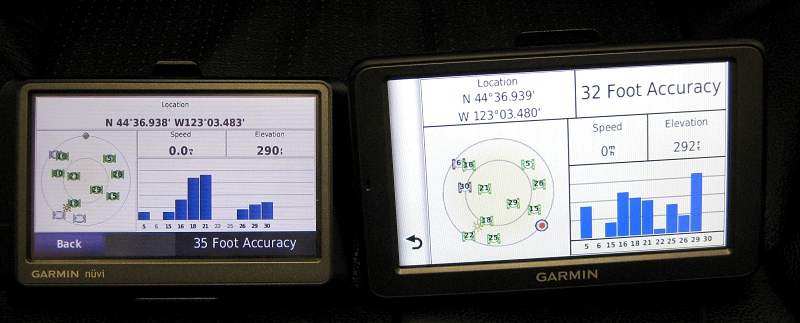

    The 465 had a weaker sat receiver inside from my tests. Like, the weakest of about 10 units sitting here actually. I got the old "lost satellite reception" verbal notice far to often. Both of them can get interfered with rather quickly by external signals, but the 560 is clearly a stronger (and possibly better shielded) circuit than the 465.
    If you tap the little signal strength indicator in the 465 main menu (upper-left) it brings up a visual view of satellites seen. Same thing with the 560, but you have to hold there for a few seconds when you tap it. I've seen CB's, XM radios, windshield cams, cell phones all mess with the position signal strength. So using this screen (or the equivalent type of screen found on other brands) you can maximize the signal by experimenting where you place it in the truck and what things are near it.

    I have looked at this screen on the 560. The ones you posted do not look the same as the newest version of the 560.
    I'll see if I can get a screen shot to post.
