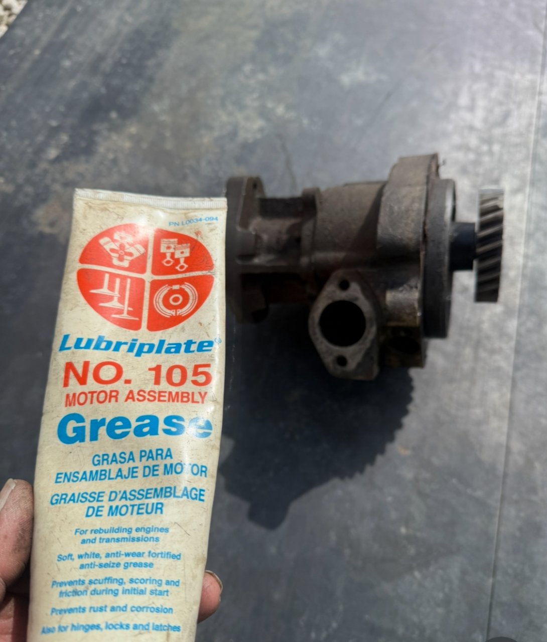

    I use lubriplate No:105 to fill the cavity of the pump around the gears, will help the pump pick up the oil quicker…..

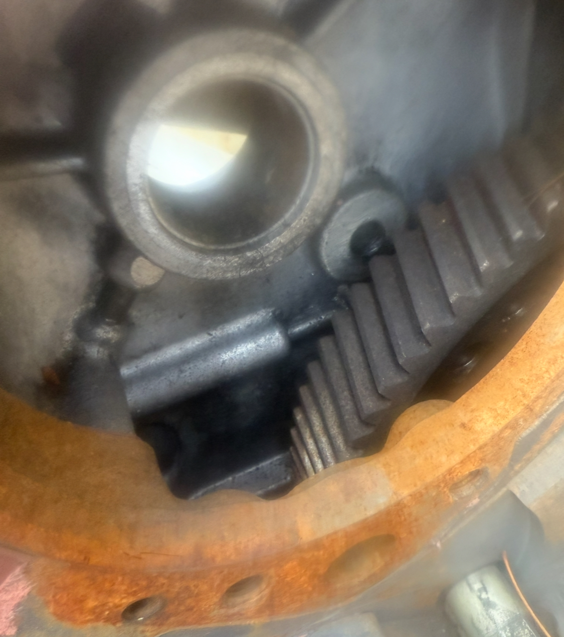

    Got plenty of the 105. Here’s a pic of it before I tore into it. The pan, suction hose and pump, can somewhat be seen. IMG_7476.jpeg
