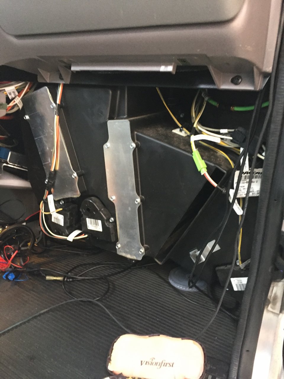

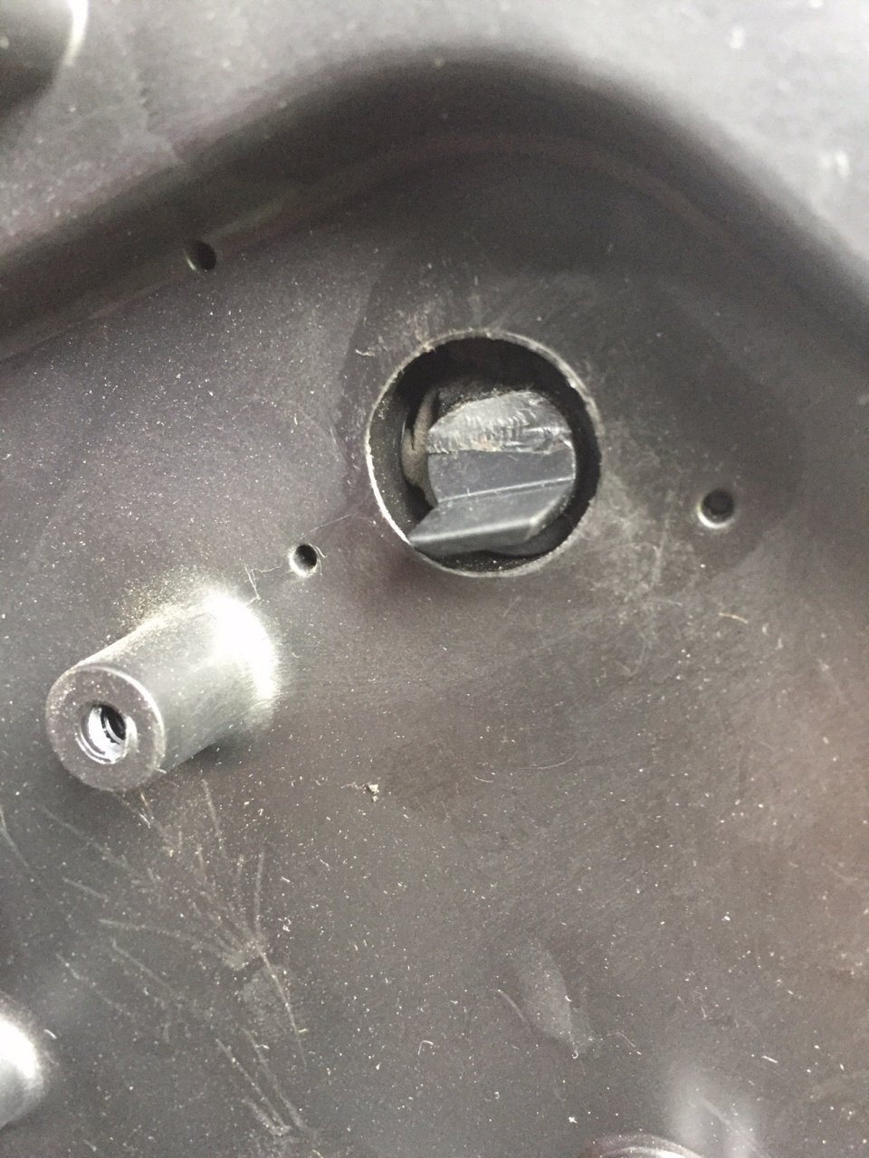

    On my rig once you pull the cover off you can see the actuators working when you turn the switches. I pulled mine off thinking it was the actuator, but it was the plastic rod that the actuator turns to flip the door. $28 part instead of $90 actuator. In the bottom picture you can see where one side of the fork like piece is broken off and wallowed out. It would turn the door but not all the way.
