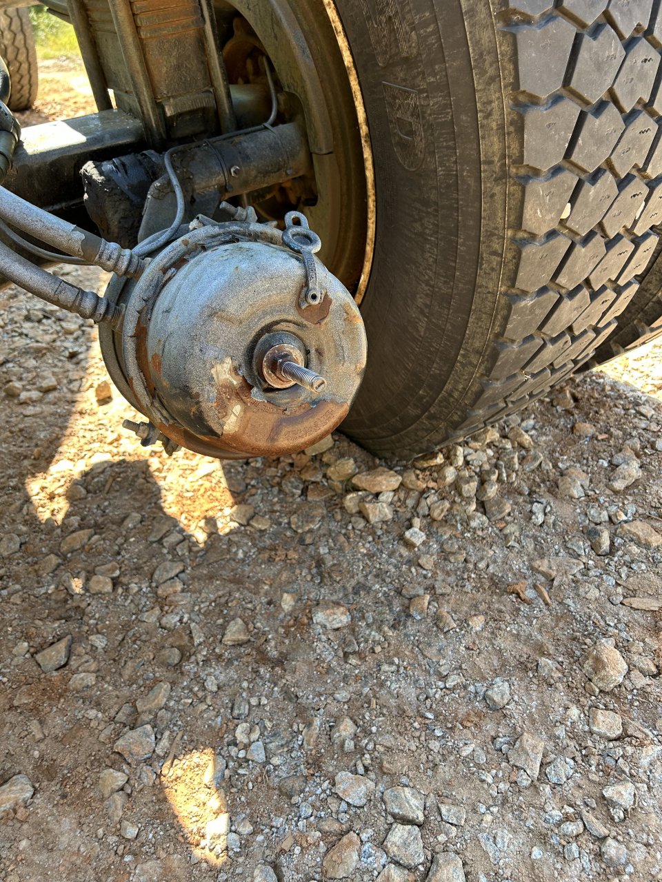

    Brakes are caged but the wheels aren’t spinning. I think the brakes have been caged for so long that they stuck on even being caged.
    Now does this shield just pop off, so u call massage the brake drum with a little sledge?

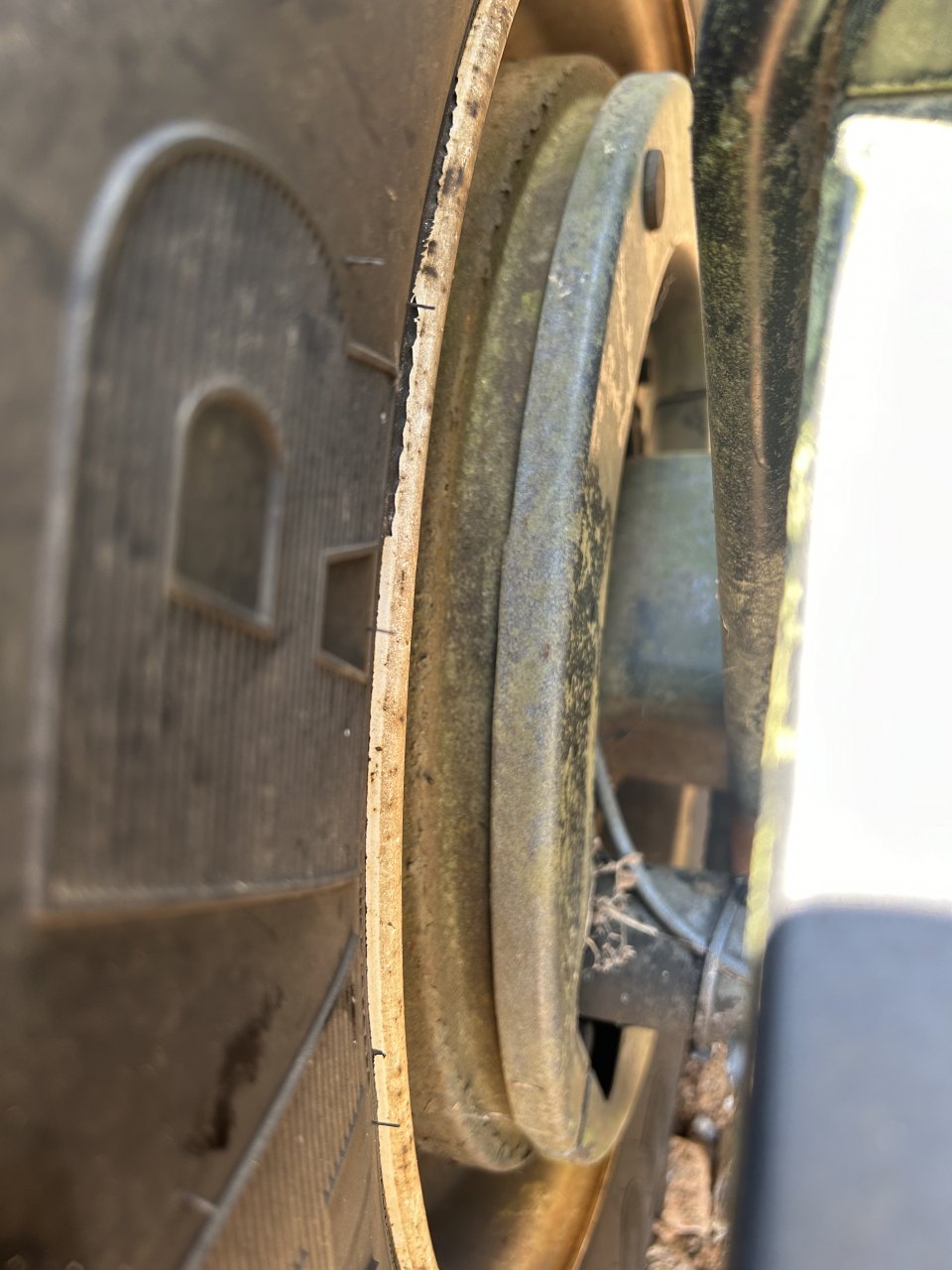

    Drum brakes have brake shoes and disc brakes have brake pads. You have drum brakes. There are 2 shields. Both should have 3 bolts holding them on. See pics. The joint/gap is where the 2 shield halves meet. If the chamber is properly caged then the shoes should barely be touching the drum.

    The brakes had been caged. But when we pulled the truck on the trailer the wheels were locked. And pulling it off of the trailer, they have been locking as well. I pulled on it with my Unimog, hoping the shoes would release when pulling it back. Maybe the truck had been sitting for too long. Anyway, I want to take those shields off and hit the drum with a small sledge and see what it sounds like.

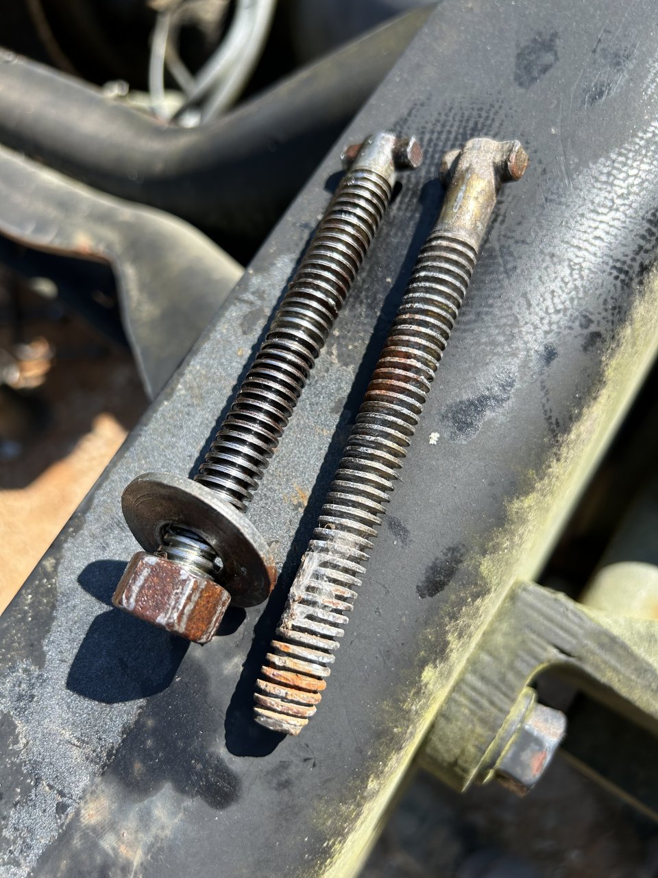

    I just noticed that the cage bolts that were on the brake chamber are longer than the ones used to cage with. Maybe the brake didn’t fully release with the shorter bolts they used IMG_1769.jpeg
