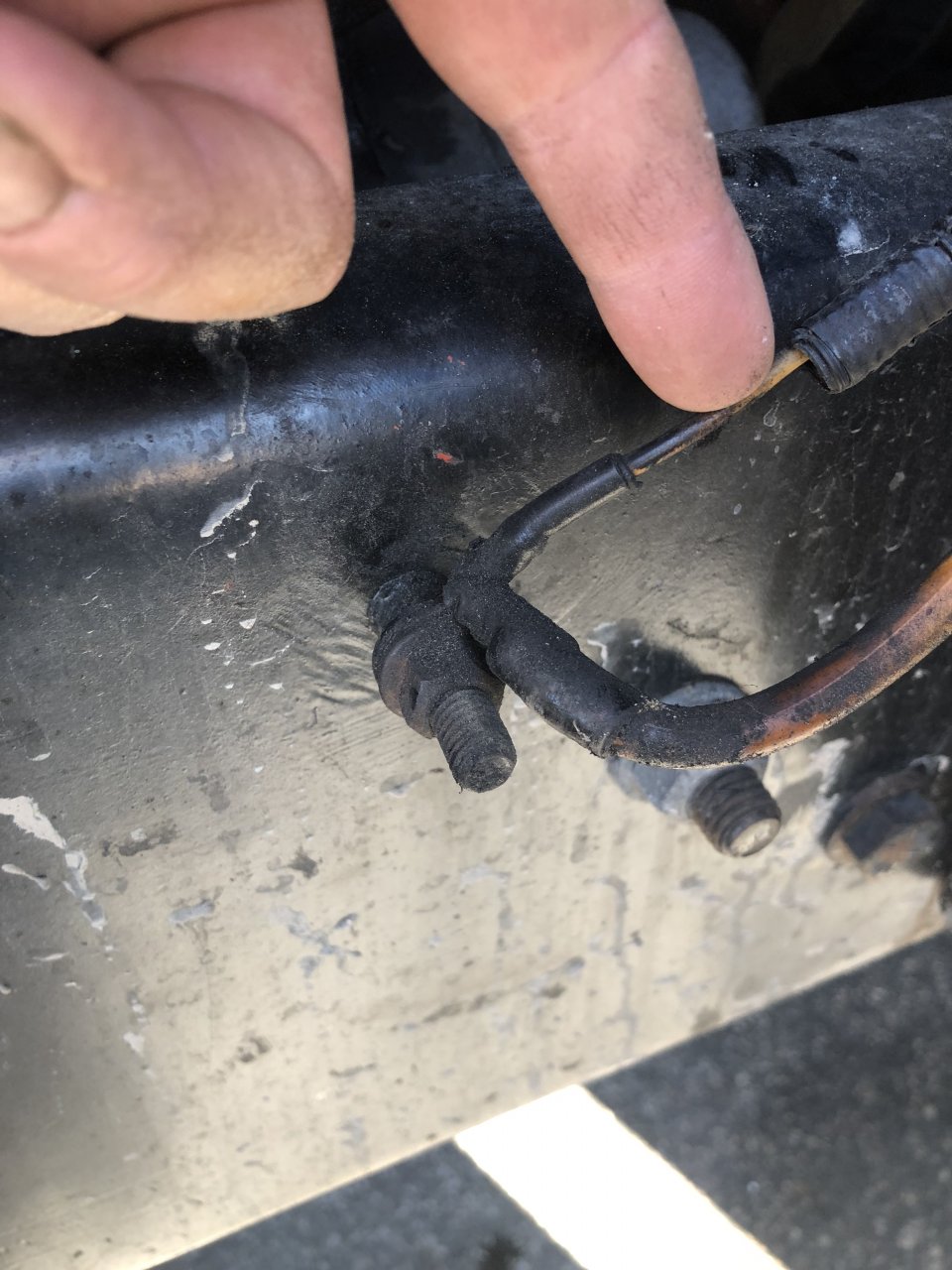

    Everything key on quit I’m not sure about blower motor. Truck is running this morning A/C won’t engage unrelated I’m guessing. Grounds look good wondering about 1 small ground being for ignition/ ecm it’s not loose I’m trying to wiggle ecm and battery wires to replicate E30BEB27-A4E0-4298-A9FB-87AC3340E482.jpeg
  11. baha
    baha Road Train Member
    4,137
    2,834
    Jul 25, 2013
    ga
    Go ahead and take off all batt. conn to clean them with a wire brush watch the 2 small wires they go to ECM then ck it to see if its running like it should?
