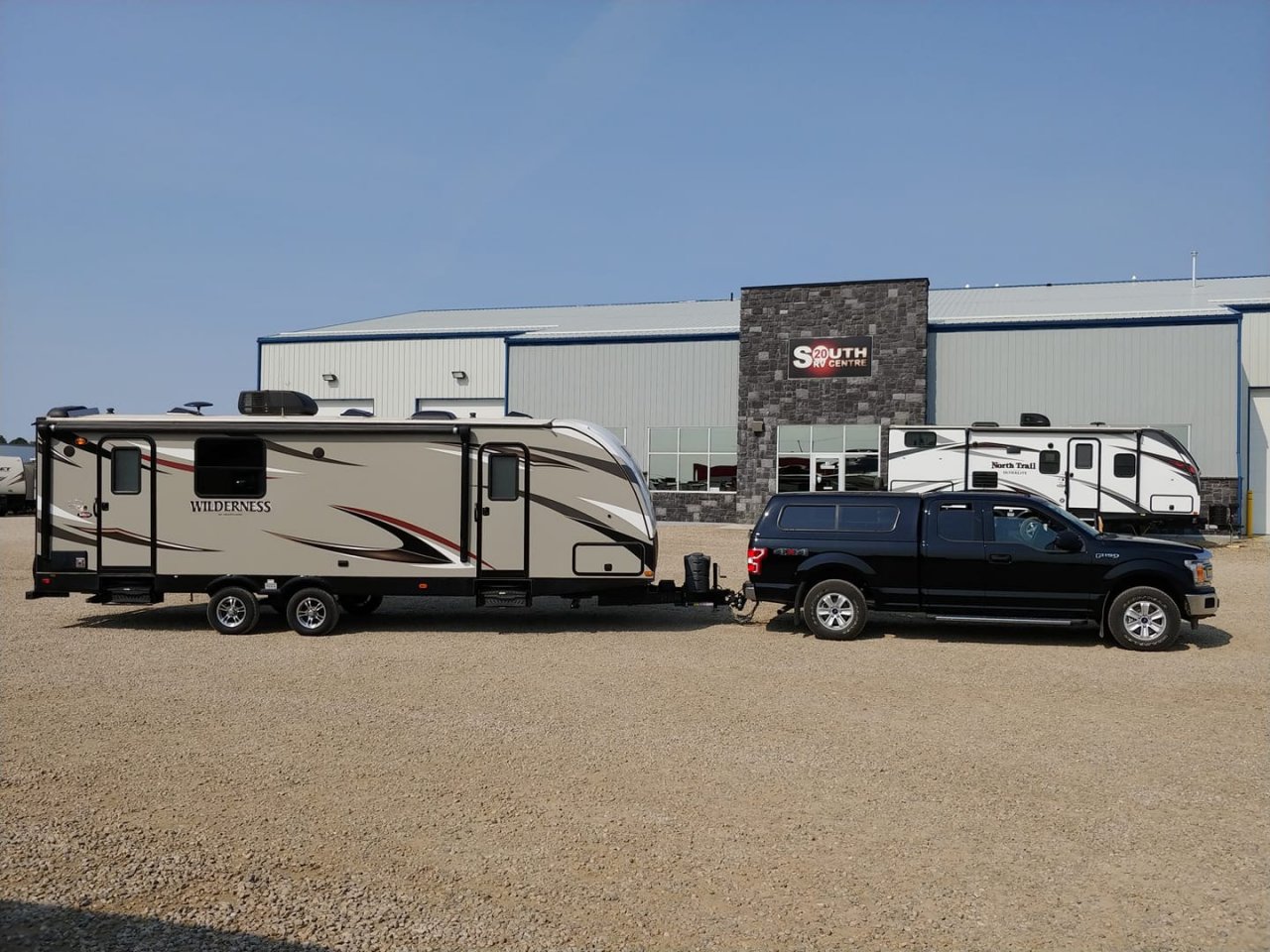

    Someone also mentioned an equalizer hitch. It is a load distribution hitch AND a sway controller. They work. I had one when I pulled a TT with my V8 AWD Sport Trac. That is a small pickup with a 7K tow rating. With a Prodigy brake controller, equalizer, and the electronic sway control, this thing towed smooth as glass. MY Tow vehicle weighd 4,500# and the trailer 6,100 wet (Verified at a Cat Scale).
