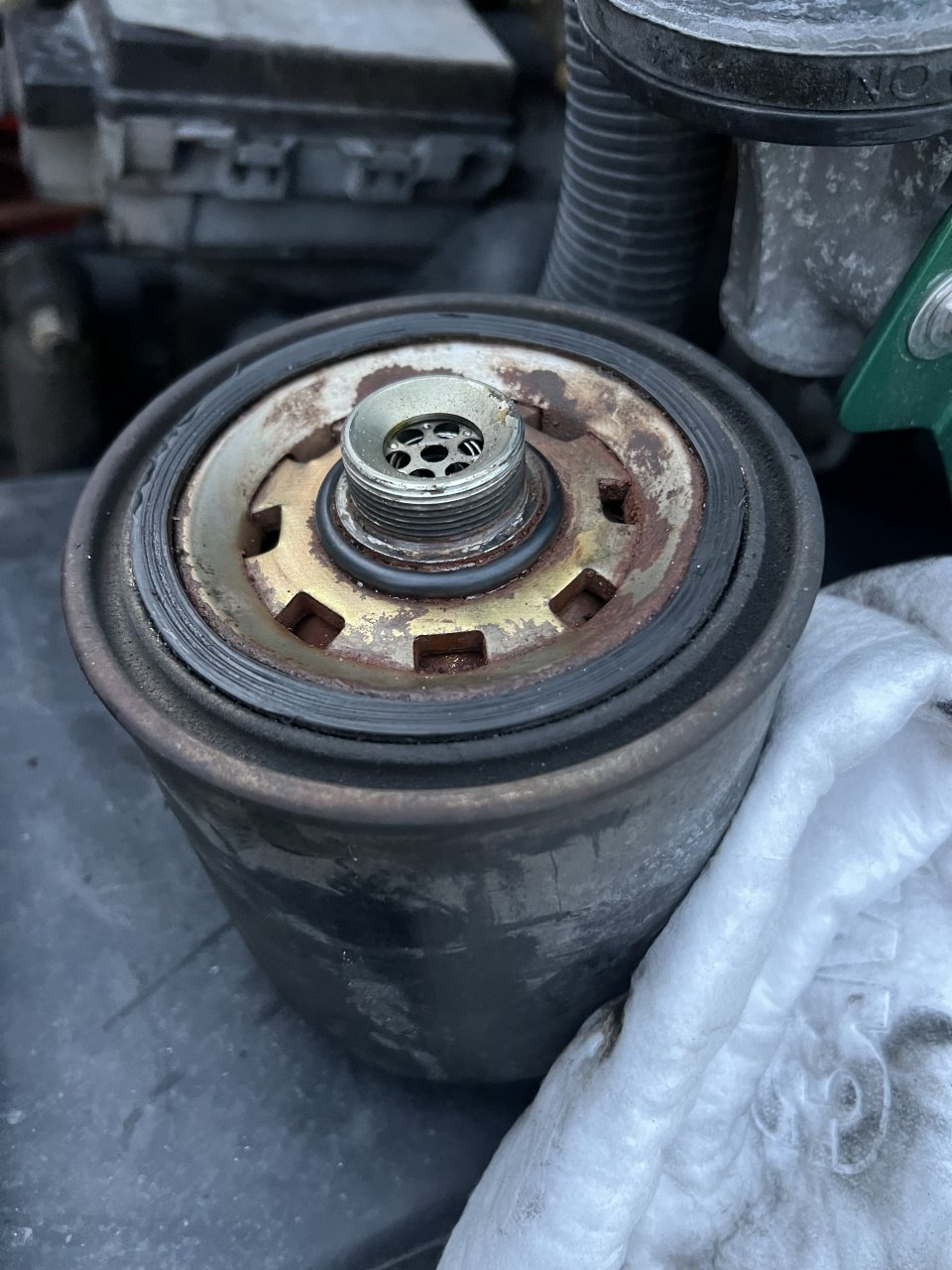

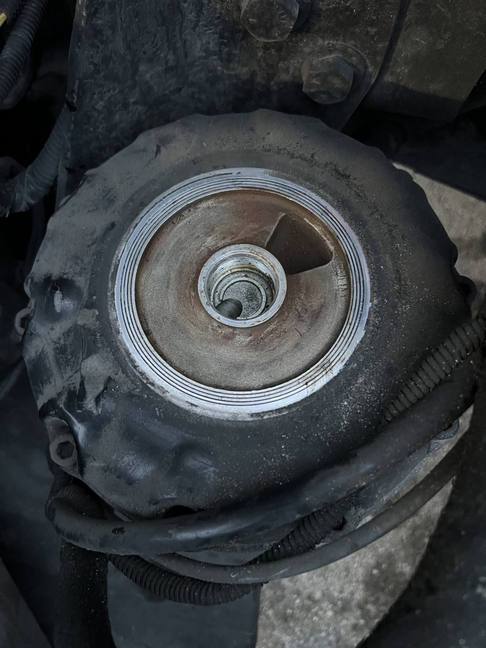

    I guess last time they change it mechanic went hard with the wrench. Can i get this valve anywhere or should I buy a new dryer?

    I had one like that a while back.
    Wabco doesn’t list a part number, so there’s no way to order it.
  4. Big Road Skateboard
    6,958
    39,318
    May 2, 2021
    Might take a sharp pointed punch or chisel and work it out, then clean up the shoulder
  5. wichris
    wichris Road Train Member
    4,451
    9,140
    Jan 17, 2011
    2 thin nuts, double nut it, heat it up and it will come out. Had a few that have done that

    Good idea I’m gonna try that

    Small disc cutter and just cut carefully around the thread

    Mine done the same thing and I called Wabco directly that is not a replacement part, buddy of mine with machine shop carefully cut the filter off of it then I just reinstalled it with no issues.
