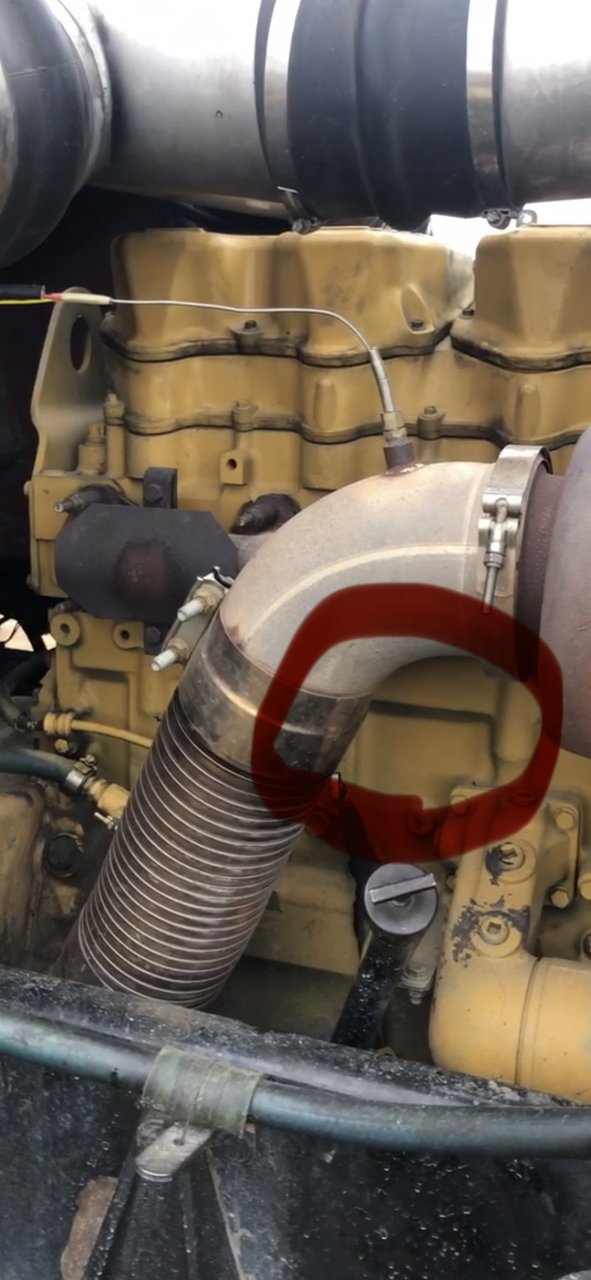

    IMG_8296.jpeg I’ll bite, on my 1994 E model, it was stamped on the block, passenger side, towards the rear. More like between the bottom of the block and exhaust manifold, just rear of the oil cooler.

    I know as a fact that mine was there. I had to grind it off for a reason. I couldn’t find any other stamp VIN on the block. Good luck

    It’s there. Get your wire brush out. It’s a bunch of dots that make the characters so it’s not real deep
    Exactly where @Diesel Dave sjowed you. If anything right behind that down pipe coming out of turbo. I’ve never not seen one there
