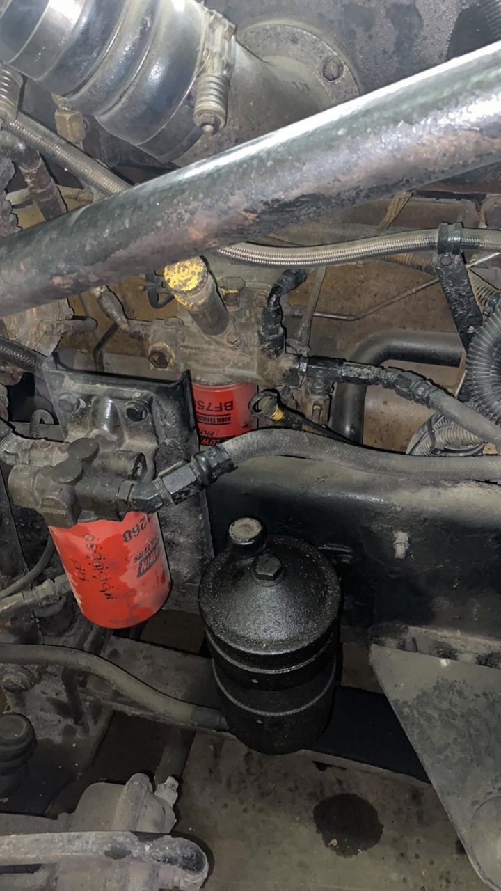

    A5FE3516-5097-4028-9110-6082A2A3F89E.jpeg Anyone know what the valve by dipstick pointing down does.

    Its on the fuel line and open so I would trace where the line runs to.

    Jun 8, 2019
    It goes into the pump. But I’m unsure what it’s supposed to do. And whether it’s supposed to be open or closed. Cause I think fuel is staying in my head causing poor power.

    It is a fuel recirculation setup to warm the cold incoming fuel with the warm return fuel. Just leave the tap shut. They got rid of it after a year or two. I think it was on MBN?s

    So what’s its current position now

    The handle is inline with the hose so its in the open position like I mentioned in my post. To shut it turn the handle so it’s perpendicular to the line.

    Yeah I know but the other one confused me lol.
