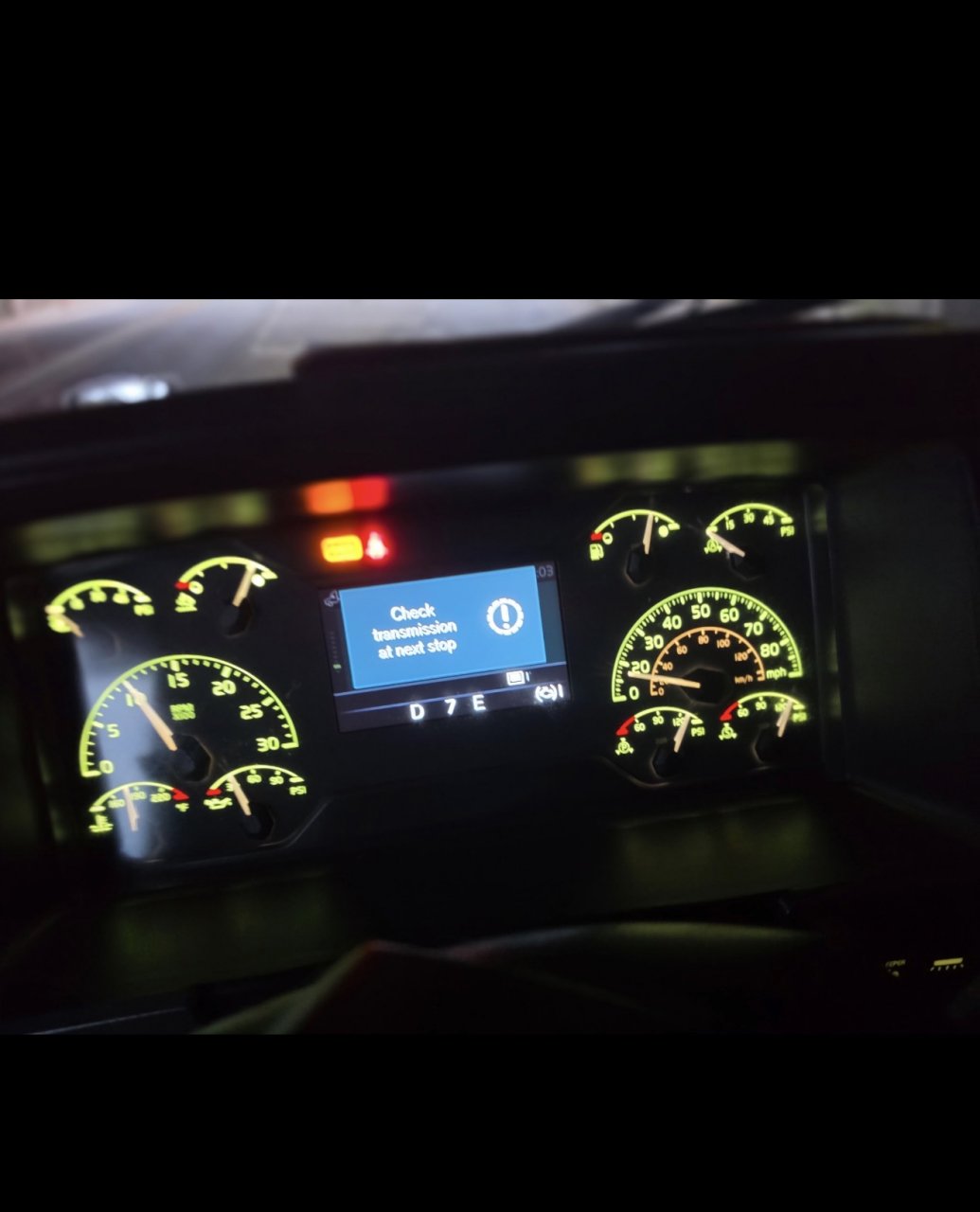

    can anyone explain why iam getting this error code “check transmission next stop “ iam being told is actuater , need to mention that when I stop the truck doesn’t go to Neuteal as before .

    change solenoid valve first possible this is causing your issues.

    Does this need to be programmed with power tech tool

    Hey man, my tech tool is recommending checking drain plug in clutch valve assembly. Still first replace the solenoid because the drain plug check won’t help? Thanks much
