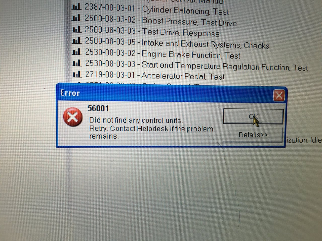

    Bought VCADs awhile back. When I go to perform a test it reads to about 30% then I get this message can anybody explain ?thank you

    J1708 connection problems

    Going to try and remove the splitter for the ELD and give it a try.

    Eliminated the splitter and that didn't work. Is there a difference between the J 1708 and J1939 adapter? I have the J 1939

    Volvo architecture differs a bit. They use 1708 for diagnostic and programmig and 1939 for ECU communication
