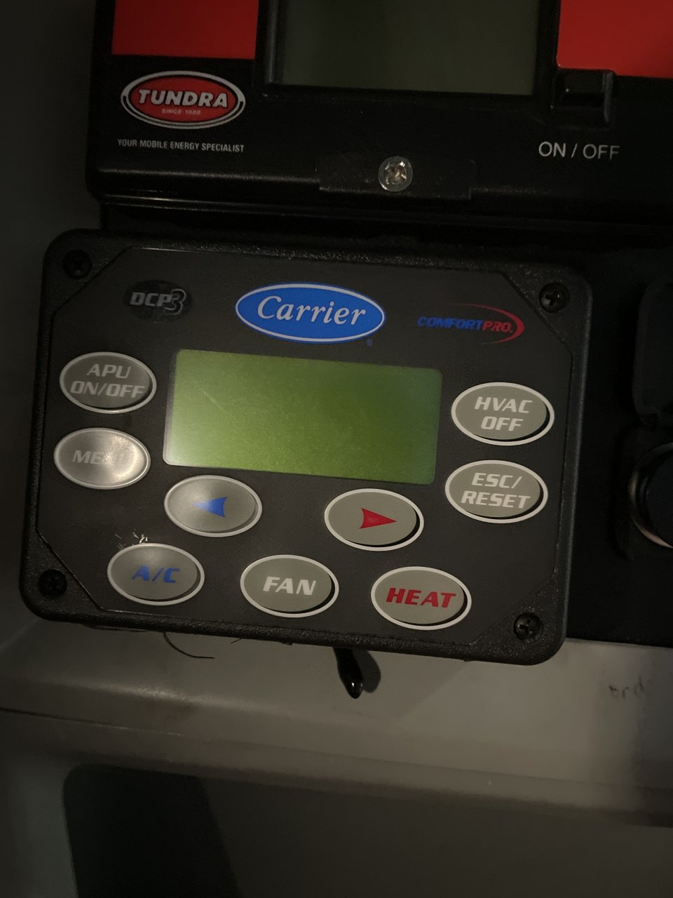

    image.jpg Having another problem with this ###### apu. When hitting the start button it’ll go to the usual “preparing to start” message(or something similar, but after a few seconds or when it’s about to crank over the controller will go completely out without any engine cranking. I’ll start the truck and run it awhile then the controller will light back up as if it was rebooting. Tried to restart it again and it’ll do the same thing. I pulled the battery cover and looked in other places and nothing was loose. Also pulled covers on the apu and hvac box sane thing, all fuses still good, and hitting the red button on the generator dies nothing. I’m pretty much ready to take a sledgehammer to the #### thing.

    I'd let Carrier deal with the nonsense especially if it's still under warranty.

    My company has started going towards the green apu’s, after so many problems with the POS carriers.
    anyhow t
    I left the truck at a carrier place to be worked on while I was home. Turns out is was a bad set of glow plugs.

    That would cause it to crank but not start. It wouldn't cause what you described. Your problem sounds like an electrical fault. I once had the power lead to the compressor short against the housing of the compressor. The symptoms were exactly what you described. When I would try to start it the control unit would say starting then just go dark.
