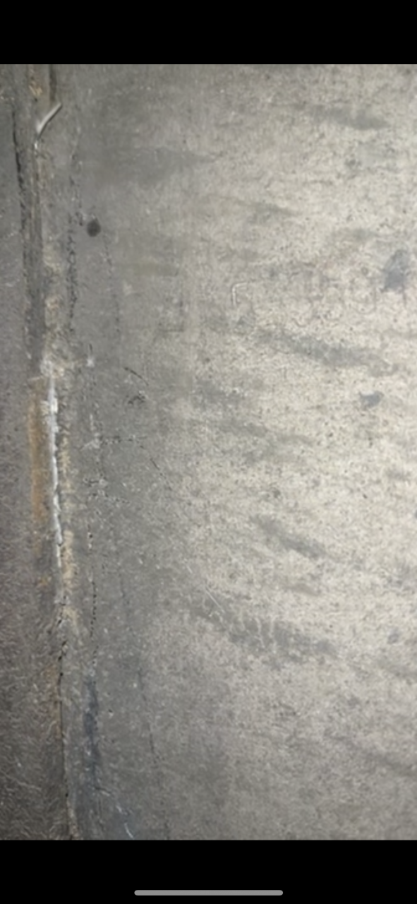

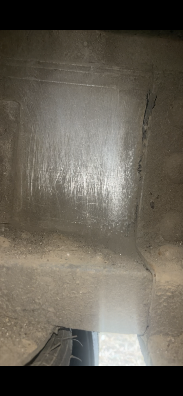

    This is on a cattle pot. 53 ft quad axle trailer. Dual dual dual lift. Frame started to crack where the lift axle bolts up to the frame. Can’t see the crack all the way through but if you look at the back side of it there’s a black line that identical to the crack in the front. No the trailer is not being used due to safety concerns of the crack. Frame is 17 ft long. It seems like to me from the front of the frame to where the crack is and maybe another foot past the crack so maybe 5 ft of the frame in not completely flat. Put something flat against it and you can move it (16th of an inch or less) Wilson Trailer said they can fix it. By welding it and plating it. What’s your thoughts on that? I thought they would have to put new frame rails in. I understand that would be extremely expensive but junking the trailer is not an option.

    Photos of frame

    Cracked frame isn't always a replacement situation. The manufacturer should have a procedure for repairing cracks.
    Weld and plating the repaired area seems to be the standard method for frame cracks. Again I'd defer to the imagineers though.

    I would let them fix it if the price looked in line.

    Its kinda hard for me to tell exactly where the crack is located on the frame from your pictures. But given that Wilson said they could fix it, I would be very comfortable letting them weld AND plate it to make the repair.
    I'm not the greatest aluminum welder, so I wouldnt attempt it myself... But would definetally let a good experienced aluminum welder do so. Someone who I really trusted or the manufacturer.

    Let them fix. They are good at it.

    Welding and plating is how every truck frame is stretched and extended .

    Not every, over 600k with no plate or channel on mine, weld only
    Be careful of blanket statements.
    That said op, aluminum is a different animal to steel, keep an eye on it after repair, if a new crack on welded aluminum is going to reapear, it will show up somewhat soon and should be within 2 or 3 inches of the weld, this is usually because of poor heat adjustment of surounding metal to welded portion, or overheat of weld itself, a good way to increase visibility would be the second you get it back, put some dykem blue (or similar) on weld and a bit all the way around it, run for a little, cracks will show as clean aluminum then
