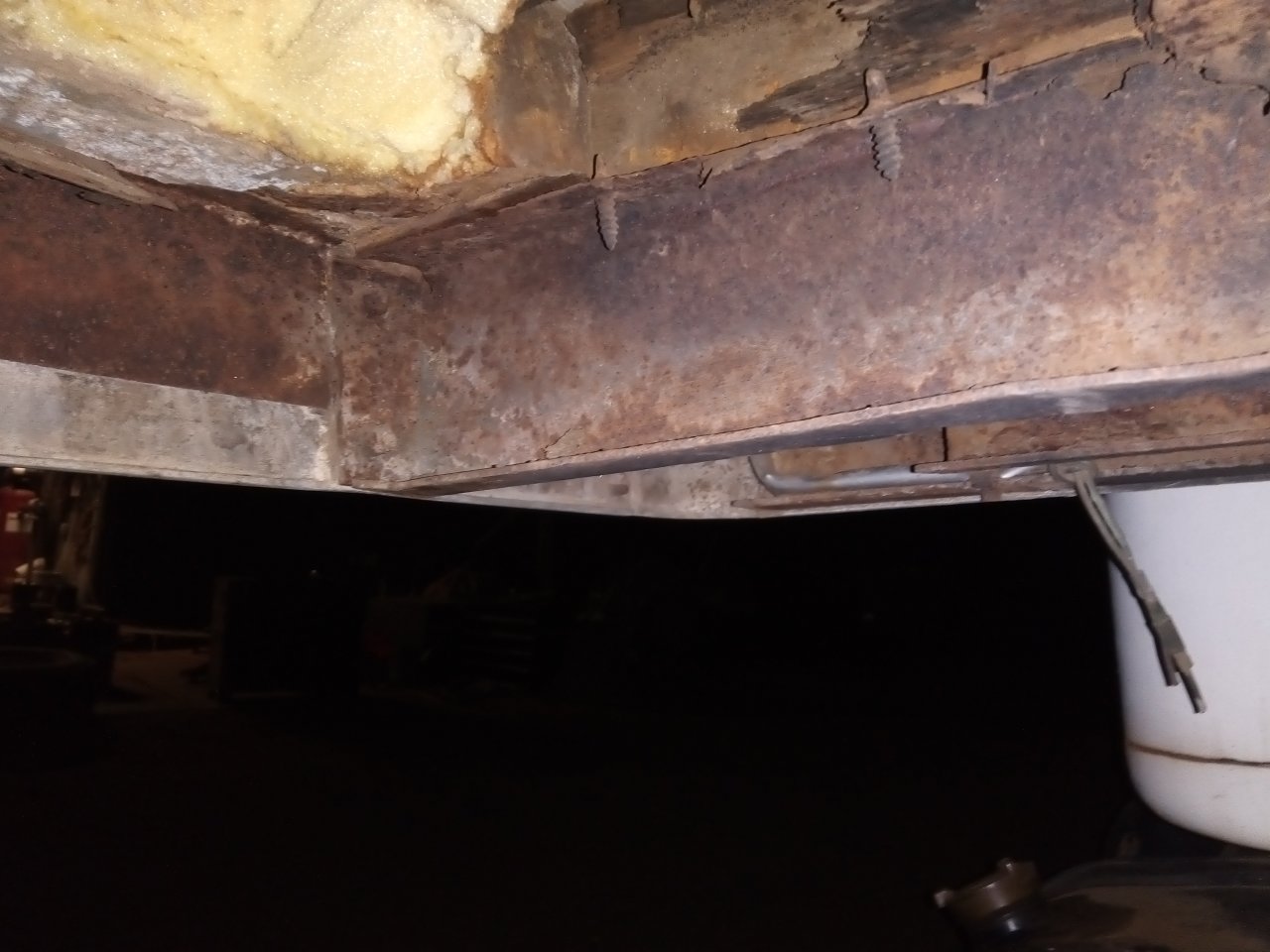

    I have an 87' International bobtail, basically a full resto. Converting to a dry box, used to be a reefer truck. ANYBODY know the legal way to repair damaged, cracked, and or rotted trailer c- channels.
    Do I have to replace each C-channel, or can I butt weld/add plate (what size, any specific weld type) to some of the more corroded ones? Any proper suggestions will help, THANKS!
    (Will post more pics very soon!)

    Here in Canada the I-beams rot in the centers from the salt, instead of cutting the end rail off and unscrewing all of the deck to replace the I beam they take 1/8" flat plate and stitch weld a piece on both sides in between the top and bottom lip. Either 2' sections on the ends or a 4' section in the center, whichever is rotted. Not sure about the top itself being rotted, I'd think that the entire section would have to be replaced but I could be wrong.

    The best way is to remove the entire "C" channel, cross member.
    I replaced a few in my drop deck trailer that way.
    I bought a trailer that someone just ground off the deck bolts and put another channel inside the rotted section. Then welded that in place.
    What ever works, I guess.
    I don't know if one is better than the other. Both ways work.
