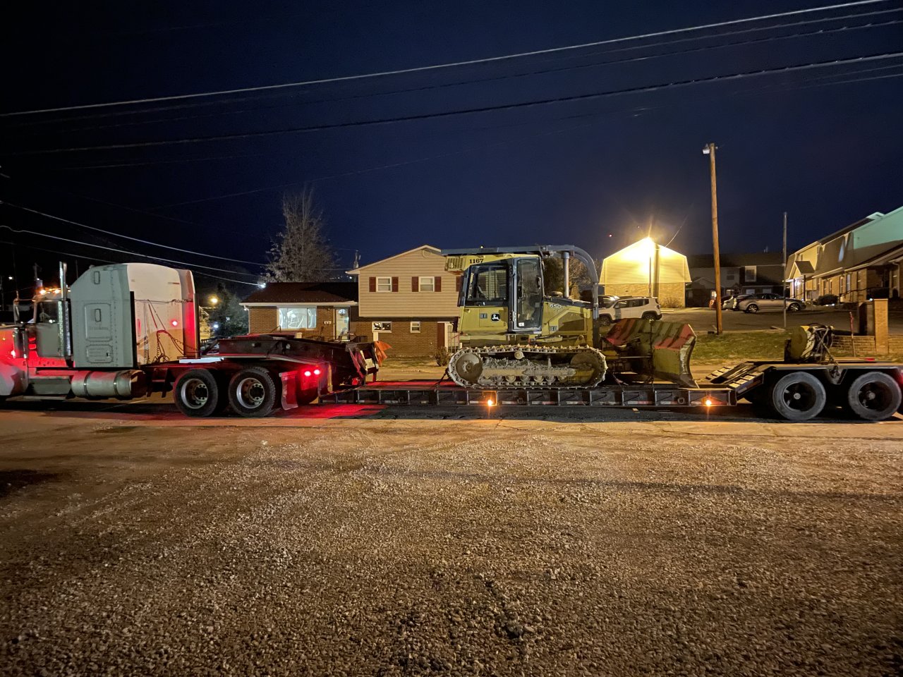

    I thought I was the only one still pulling a wagon with spokes lol

    Nope lol, everything I have is different. Lowboy has Daytons, flatbed is hub pilot, and tractor is stud pilot…
