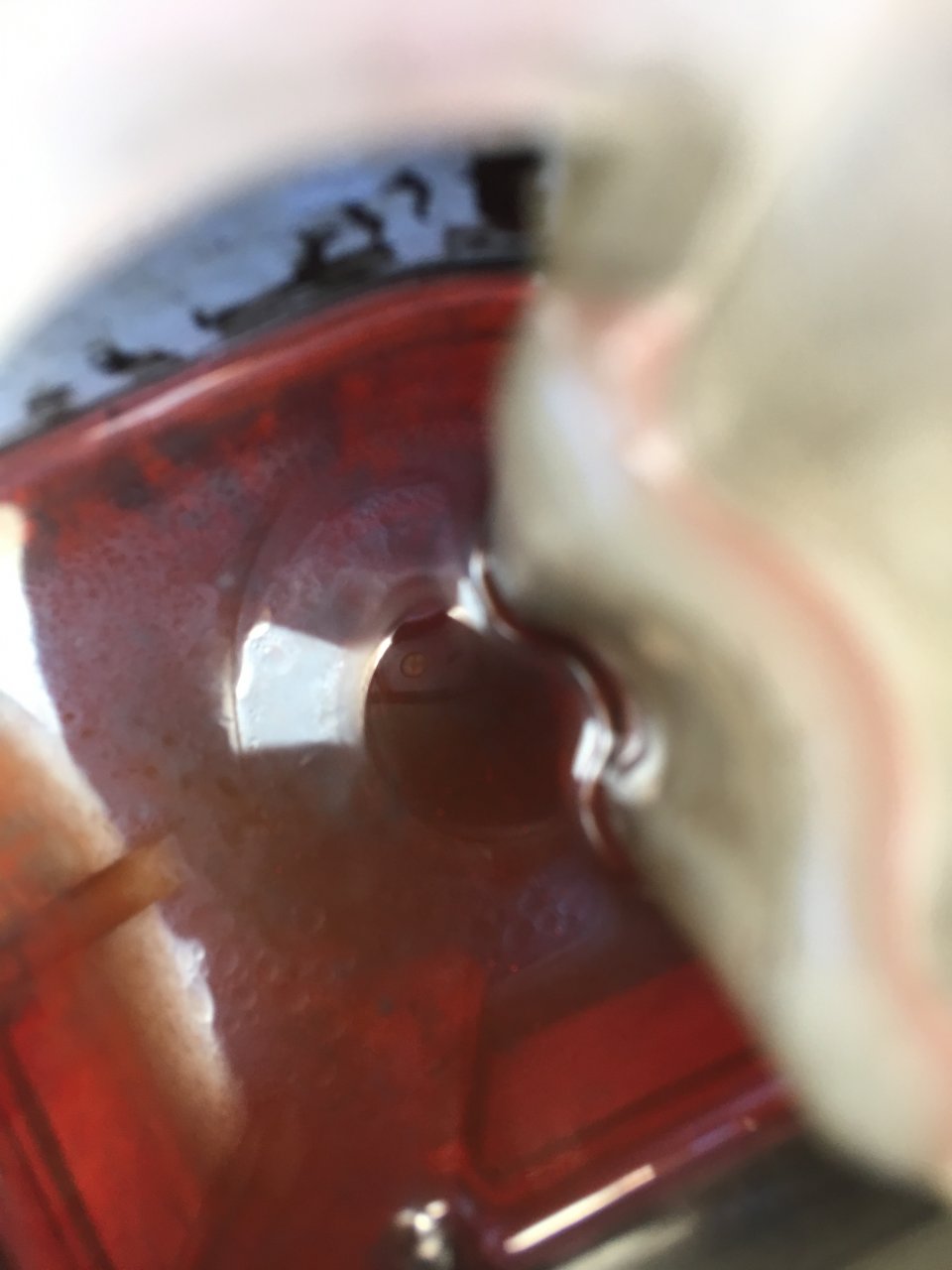

    Have same issue but did not change oil cooler. On my reservation r there is blaci specs seimming on top water and also on the bottom floor of the reservoiir looks like dirty black in color. My coolant was green i changed it flushed it good and added red coolant...drove to texas and back and coolant looks dark purple...where it conects to the hose it is red the specs inside make it appear dark. Also when coolant goes up and down it leaves traces of that black stuff on the reservoir walls. I also unscrewed the bottom hose under rad after flush and put my fingers inside and my fingers were black as charcoal. Engine looks as if recently rebuilt...bought the truck a month ago...could it he dirty system from previous owner? Truck runs amazing oil pressure between 30-60 temp always 170 pulling like a beast on stereoids engine is 12.7 500hp detroit 1999 model has lots of blow by oil level stable what yall think ?

  6. Rasim
    Rasim Light Load Member
    96
    16
    Jan 24, 2014
    Here are pictures
