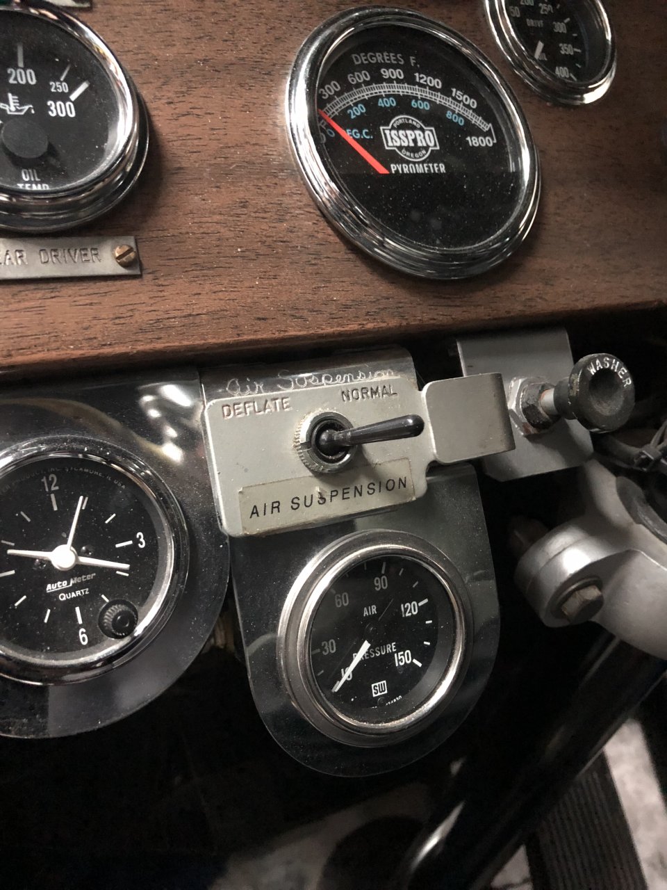

    I used one to make a dump valve on my old Air Trac. Plumbed it with a air system pressure gauge to make a suspension load pressure gauge. The switch was probably 20 years old when I installed it 6 years ago. No leaks yet. I even found a guard for it out of another Pete.
    I fabbed gaurds for these two old school ones out of aluminum flat stock.

    Good Job. I’m guess the air switches are already in place for the indicator lights. For some reason I was thinking there’s a wire going to mine. But no, just an airline. I’ll get some from the Pete store. Thanks. I hate the big bulky ones I got. Not much space on Freightliner dash for more gauges. I could have just gotten a 2” pyrometer gauge. I have a spot for one. But the 3” gauge looks much nicer. Next will be a 2” fuel pressure gauge, in the empty spot. Thanks.
