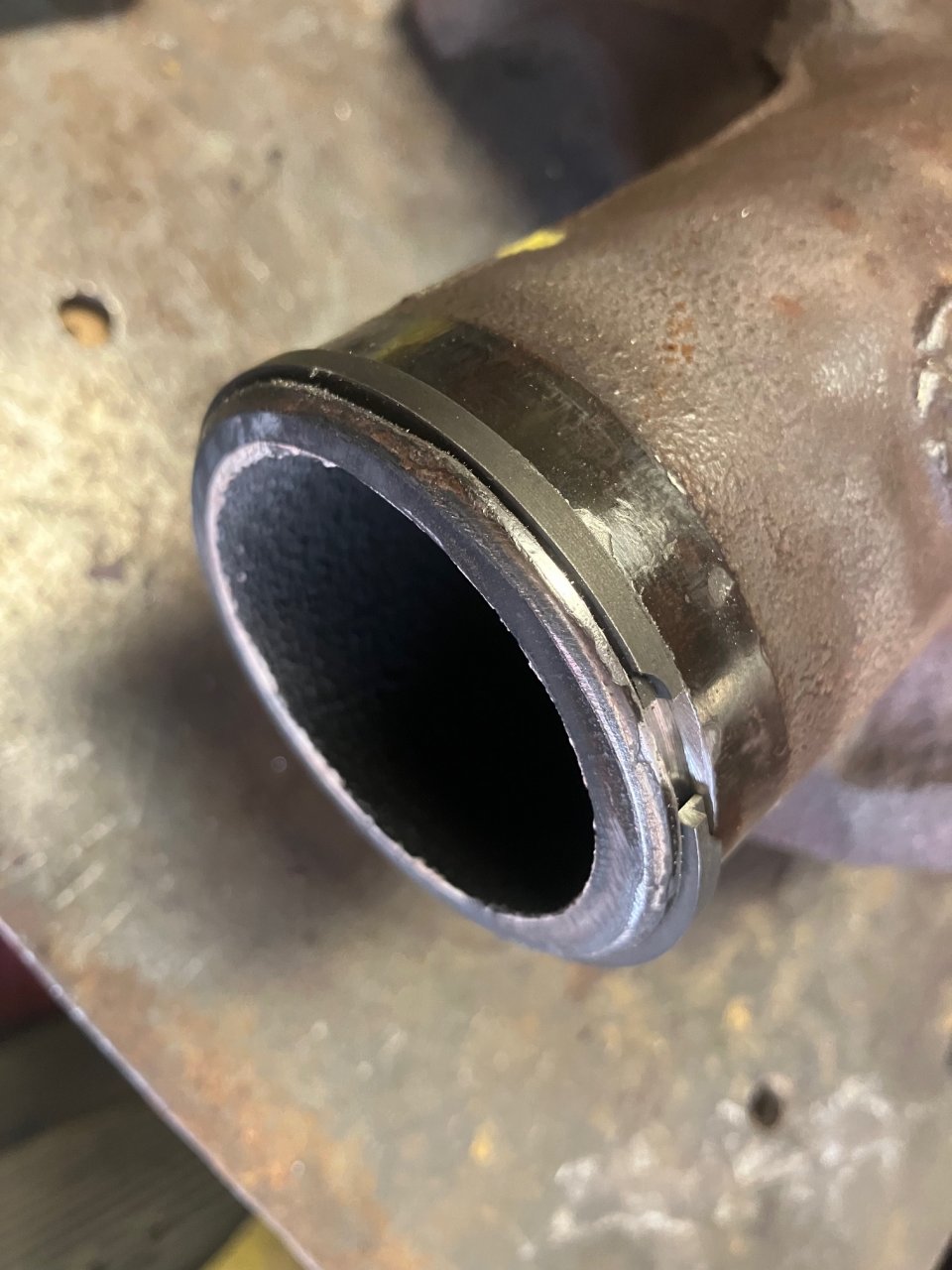

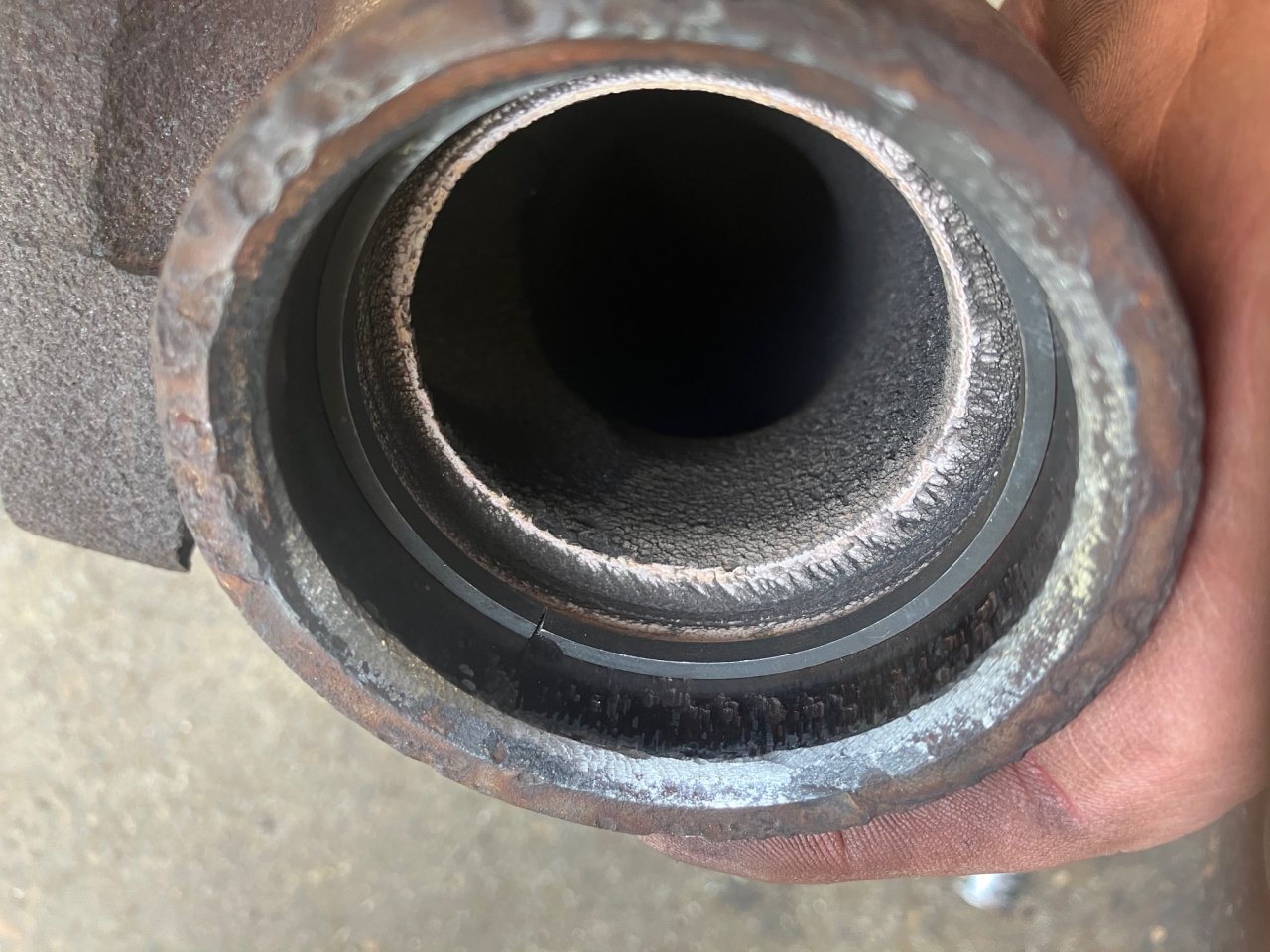

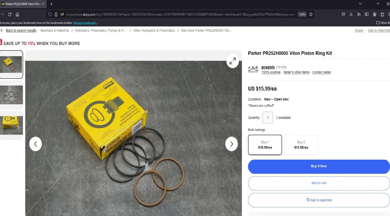

    Found some cast iron piston rings on ebay 4 of them for $16. exactly 2.5" diameter. they were a bit tight, inside manifold was about 2.480 so used ring filer and sized them up to have about .002-.003 gap. Used 1/8 cut off wheel and a hose clamp as a guide. Groove looks deep but there is still .125 thickness left if not a bit more. Was debating on putting 2 rings there w/ .100 space between them.. I am going to, I have them why not... its a pain to grind the grooves and keep them accurate all the way around... time and checking with caliper every pass with the grinder. I compressed ring and it did install inside the other half.. I dont see how this seal can fail.

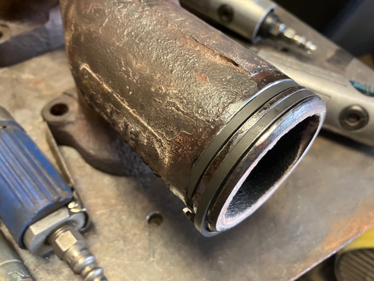

    Decided to put the second one on, why not... they fit tight.... rings got .002-.003 gap so hopefully wont expand and crack, if so they are not going anywhere.. and should still seal and impossible to blow out. Good fix and repair for $16. and a few hours.

    Looks good. Does it move easy enough ti not damage the rings during installatiion?

    Thanks. Yes I smeared a little grease in to help the rings go in, it will fall apart if im not careful carrying it. Waiting on manifold gaskets now. I dont know what the rings are for, but its about as much tension on it as a piston and cylinder wall.. I dont expect it to seal like that though its not a 100% perfect surface, but should be sufficient... My fingers are crossed.

    Not sure what they fit but they are $$ if not purchased off of ebay. https://www.hydradynellc.com/product/pr252h0005/2h-3l-vh-series-piston-ring-kit
