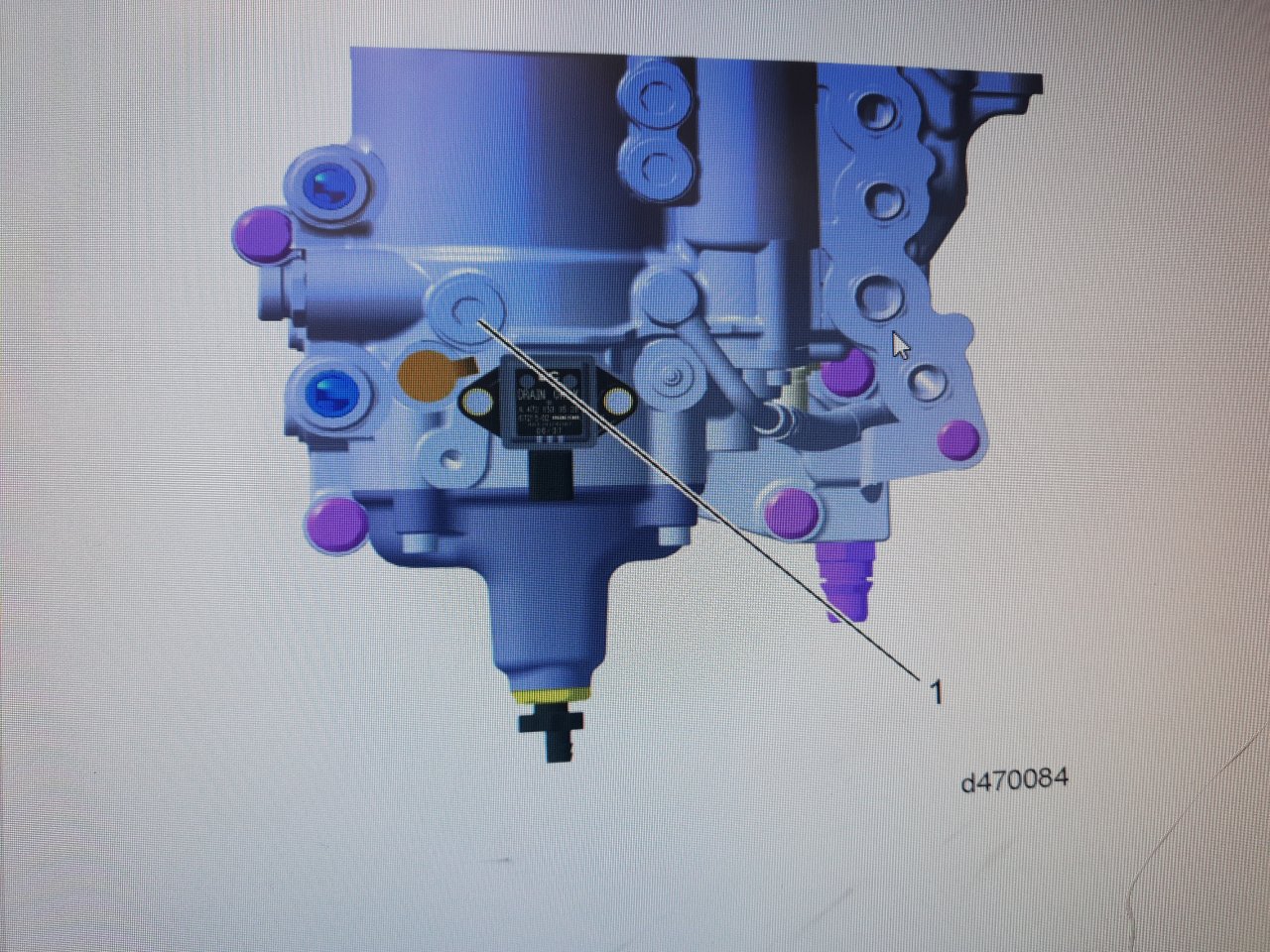

    Got a 2010 freightliner cascadia with a DD13 with the 3 filter fuel setup.
    It has a extended crank time on initial start ups. As long as it has been running within 3hrs it'll fire up normal. Otherwise, it goes through about 4 cycles of the starter overheat protection to build low pressure to 30psi then fires up. No issues with driveability.

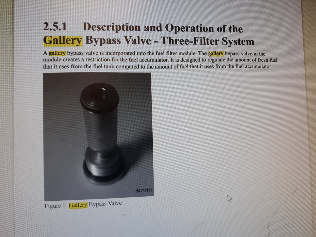

    I'm kinda looking for some information on the fuel gallery bypass valve. It's mentioned in the manual of the system overview, but not in any of the troubleshooting. So I dont know what symptoms of a stuck valve and not much experience with this fuel system (it looks rediculous though). I'm leaning towards a suction is weak on the low pressure side, but would like to eliminate this valve being an issue because it's part of the filter housing and not the pump.
    1. Fuel level is good.
    2. No active or stored faults
    3. Rail pressure does not go above 150 bar (2175psi) until low pressure starts building.
    4. QCV current while cranking is below 2800ma (does change between cranking a key on engine off).
    5. LPPO (low fuel pressure) is below 30psi for about the 4 overheat cranking cycles then builds and fires off.
    6. Don't have hose adapters to measure suction. I did blow out the lines running back to the tanks to make sure there wasn't any restrictions.
    7. No external fuel leaks
    8. Pressure limiting valve is new.
    Ckp signal were good and it passed compression testing and rail bleed off testing in DDDL.
    PLV, QCV, and prefilter valve & filter have been replaced. First two within the last 6 months. Prefilter valve I changed Friday (2 days ago) to eliminate.
    Thanks
