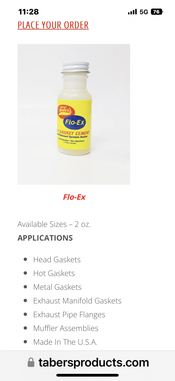

    5494868B-28E2-42E8-A2E2-0E7D67F6002A.png They call it a cement. Supposed to expand when hot. Sold in 2oz. bottles for $3.75 direct from manufacturer. Never used it myself. Supposed to be good stuff.
