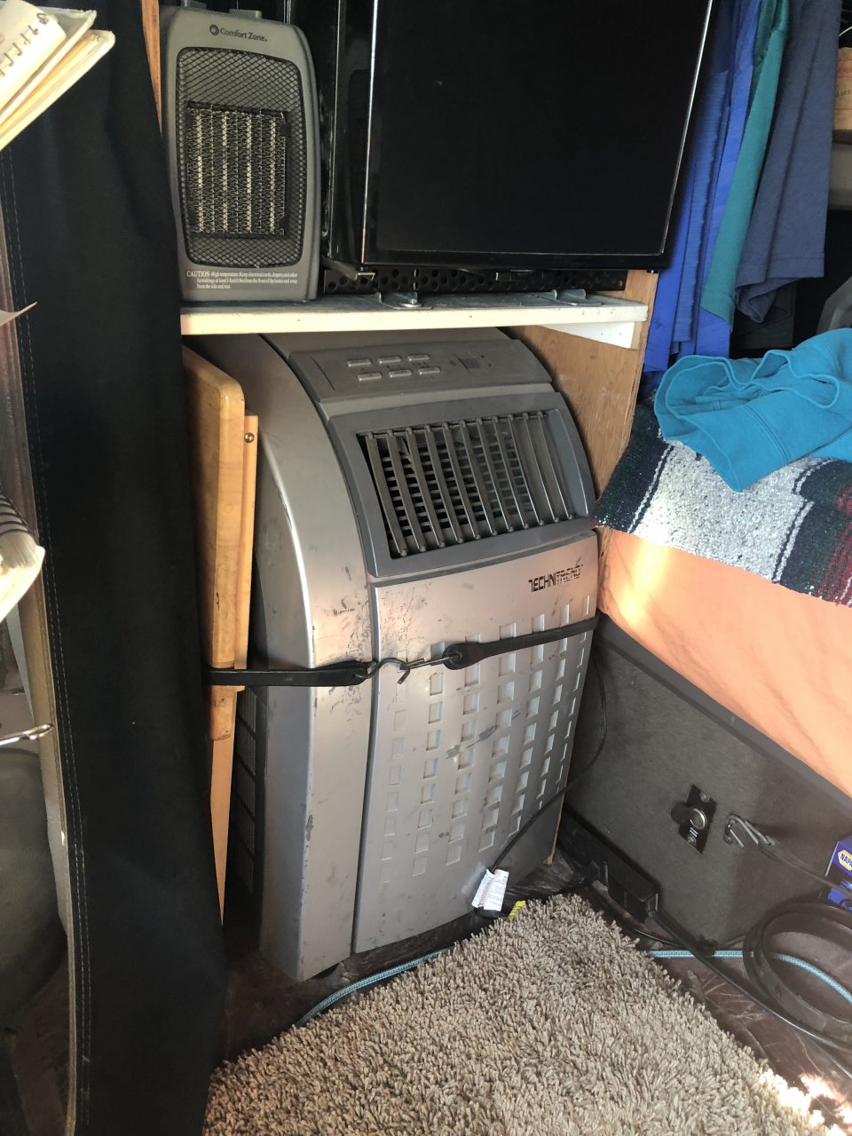

    2 6” holes in the floor. Boom done! FA7CC875-7A8D-472E-A1BF-9D5630E41246.jpeg
    On the hottest of hot days it won’t quit keep up so I just idle, maybe 10 days a year? Tops
    whoopNride and HopeOverMope Thank this.

    Yea I’ve seen yours, been deeply considering your set up as well. Only thing is i have a huge fridge already taking up real estate, I would have to lose my other shelving, but.
