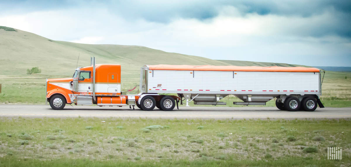

    This truck has sanders built into the storage boxes in front of the drives, you can see the tubes hanging down below the box. So a truck like this could appear to be running without traction devices when they in fact are equipped with them.
    Rugerfan, Oldman83, Oxbow and 9 others Thank this.
