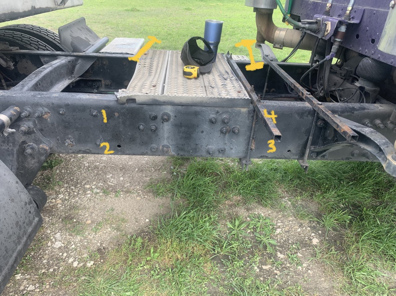

    6C9D5E4D-AE68-44C8-BB11-32DFD453B991.jpeg Hey Guys,
    1999 Freightliner Century, with average rust on the frame. I would like to hang a box on the passenger side, but will need to drill 1 hole in the side of the frame. Is this risky with the truck being so old, and somewhat rusty? Pic attached, #4 is where I need to drill. Yellow marks above coffee cup shows box already mounted same exact spot, opposite side of truck. Thanks!

    That rust is only on the surface. You will discover real quick just how solid that frame still is once you try to get a bit to go through it.
  5. jamespmack
    18,414
    200,996
    Will not hurt anything. But word of advise, do not drill above or below current bolts going towards flange. That's were it's heat treated, you will have a really hard time.
    Heat treat is in flanges, not center of web.

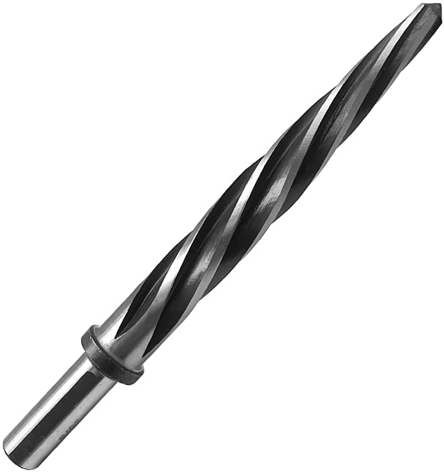

    You can, 4 holes you can do with a cordless drill. Just know if your big bit, is high speed, or low speed. You really wanna zip holes buy a a fluted reamer bit. Drill a pilot hole, and a good 1/2 cordless will walk right thru it. If your moving axles or changing mounts, the mag drill is your best friend.

    I once did frame inserts and swapped from reyco, to KW 8 bag. Shop boss was kinda a prick. Company owner seen this and told us to stop. He would get a mag drill and we can resume when it shows up.
    This is just for a picture. I have no idea the specific brand quality. This will get it done. Now put this in a mag drill and it's like slicing butter.
