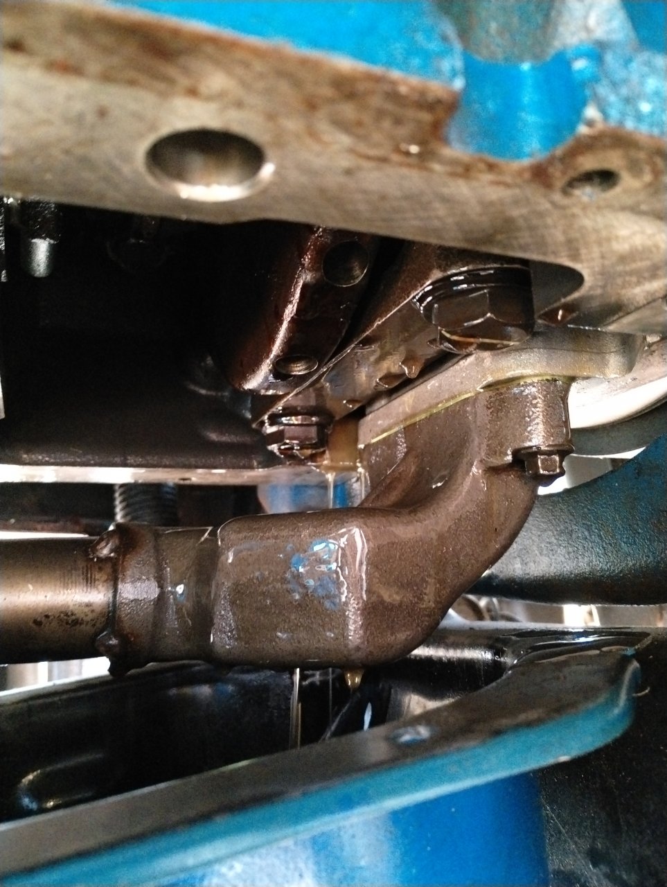

    Next week I'm hoping to get back on this project. I plan to place an oil container under the pick up tube while a helper turns the engine over to see if it will pick up any oil. I'm assuming it will not, and that the oil pump is bad. Any comments on that plan?

    I replaced the pump during the rebuild, and mistakenly put the wear sleeve in the wrong direction with the taper towards the damper hub instead of facing into the engine. I noticed the mistake as I pressed everything together and put a new sleeve on in the correct orientation. I also was unaware that I needed to prime the pump with grease during installing and I only coated it with assembly lube. Considering it took a long time to build pressure initially, and I'm now loosing prime, I wonder if I damaged something with the initial improper install. Possibly grooved the oil pump housing plate.
    I did check the regulator and bypass valve, part #3 and #4 on page 281.. My thinking is that if the pressure bypass is damaged, I will see oil flow from my container and it will come back to the pan.
    I cleaned the fitting, but I did not replace it. Should I?
    You have no idea the headache I went through to try and locate that manual and get a printed copy. Lol. I finally found it online and had Office Max print and bind it. I was not going to even attempt this project without the manual.

    I held a bucket under the pick up tube while my wife turned the truck over and it started to pull oil right away and then seemed to slow down. I'm not sure at what rate it should be pumping, but it is moving oil. The oil was coming right back out directly above the pick up tube though, as though it's coming from the back of the pump.
