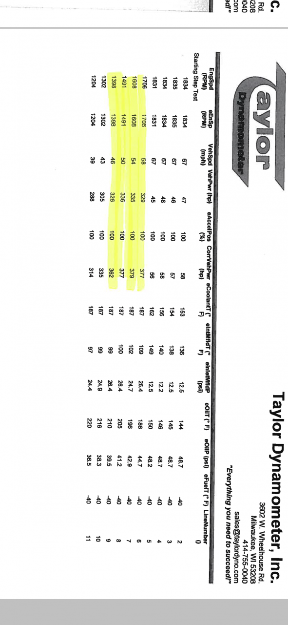

Can anyone please read me this dyno result please. Share your thoughts on the report
i think rpm is high.. i can be wrong.. please advise thanks

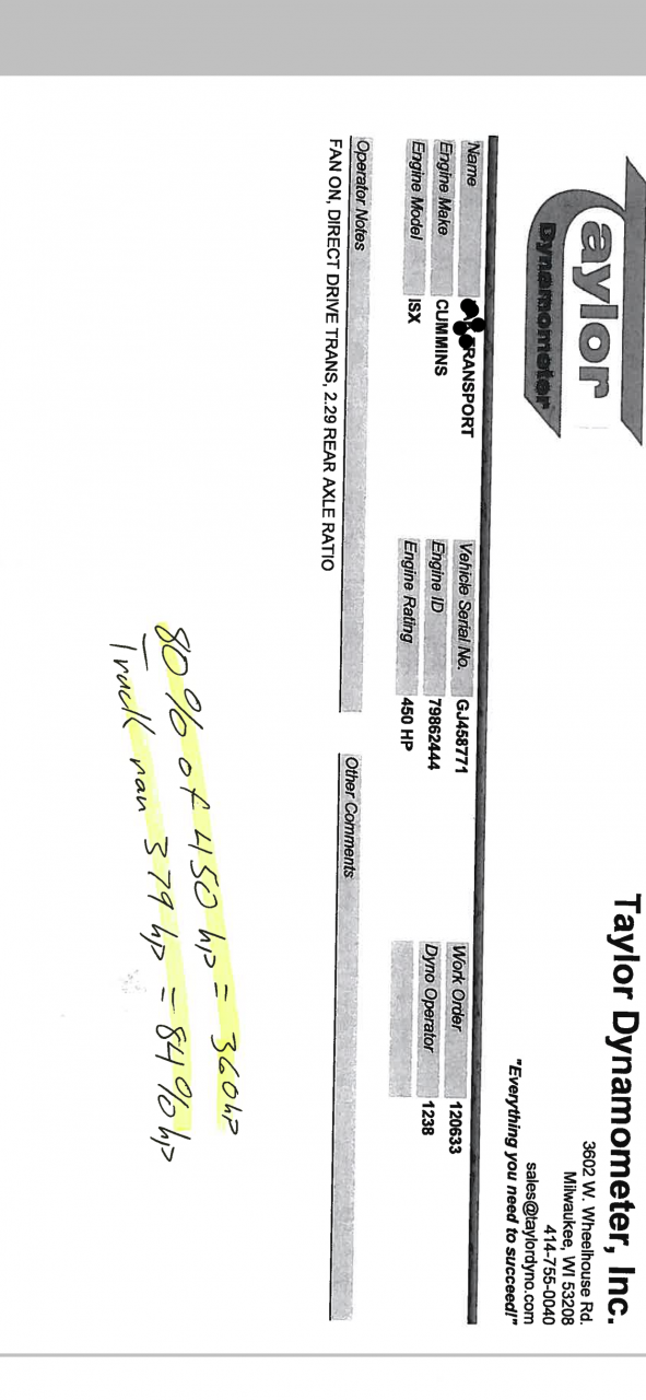

What do you mean RPM is high?
If that's power to the ground, I would say its fine. We dyno'd a new 500 hp Series 60 many years ago and saw 411 to the ground.TallJoe, D.Tibbitt, Newbieboy and 1 other person Thank this. -
84% of rated power to the ground is good. Most common reason to do a dyno is to measure blowby and hp to the ground. Just measuring hp seems a waste.
Where is the blowby, the most important number. But because it is above 75% of rated power, it looks good.

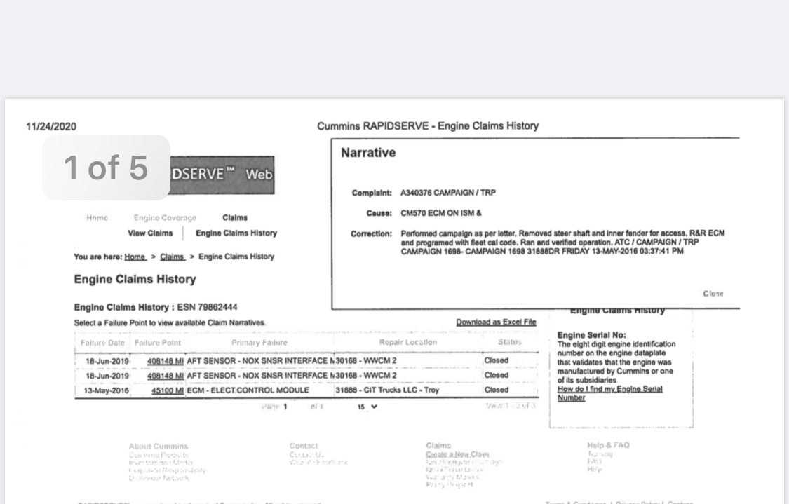

I am buying truck from CSM KENWORTH WISCONSIN.. just now i got this repair detail from CSM. Currently truck have 428k miles on the dash. Ecm is replaced back in 2016.
should i go for this truck or not?Attached Files:
Currently truck have 428k miles back in 2019 June truck had 408148 miles. You guys think odometer is tempered? @Chinatown
(There is no way to measure blow by on the newer dynos. We have not measured blow by for years.)Last edited: Nov 24, 2020

Honestly its making good power I wouldn't even worry about checking blowby.
