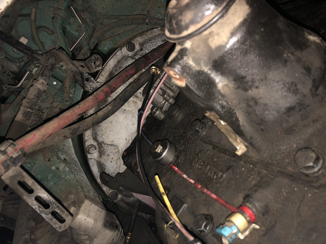

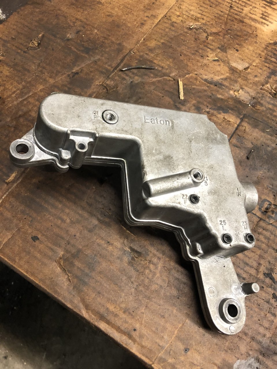

  9. Abdul1974
    Abdul1974 Bobtail Member
    7
    Jan 12, 2019
    We got new air module
    On top i can see only this on the cover. Will check more on top now
