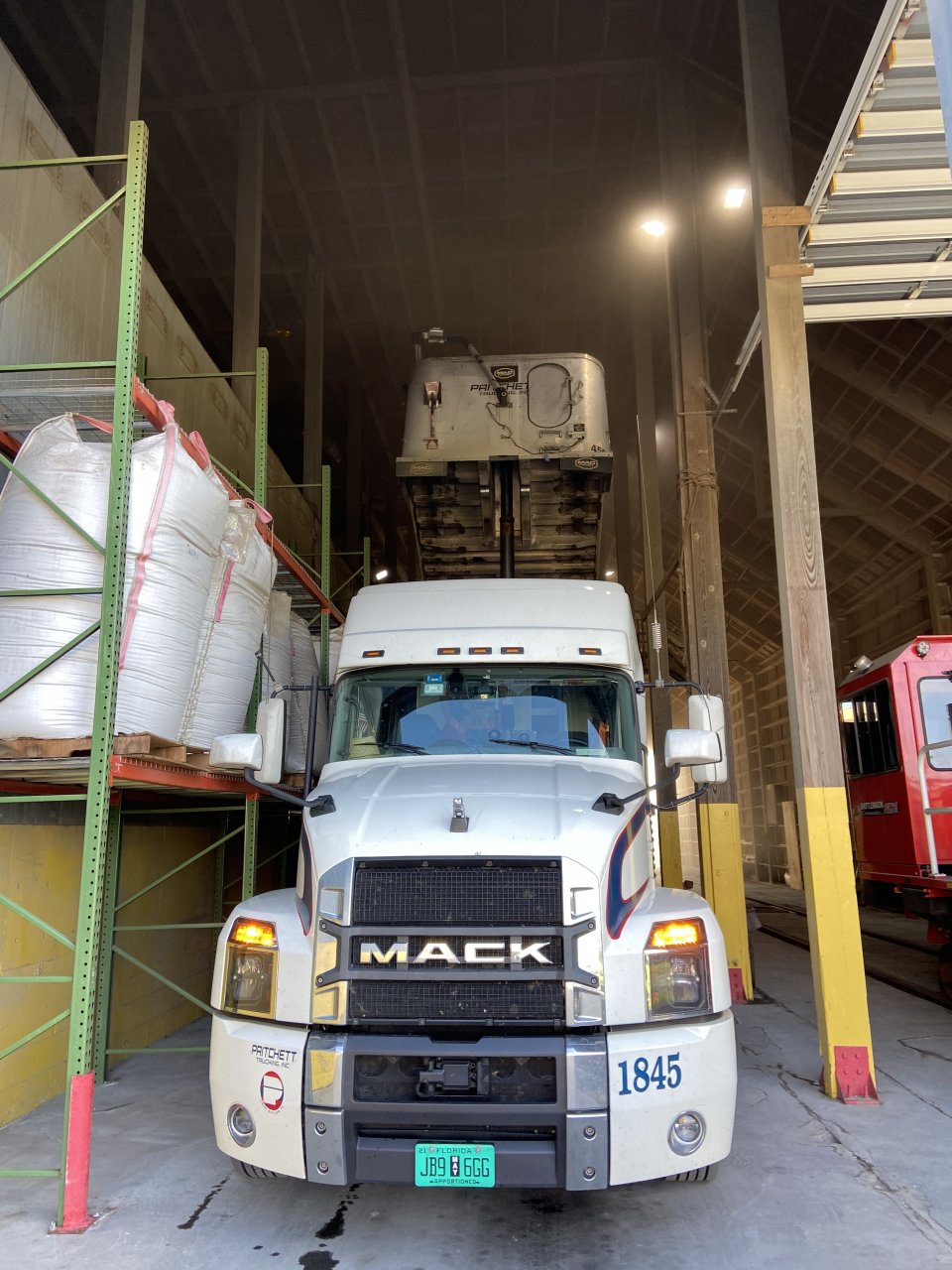

    A lot of feed mills can’t accept a end dump due to height restrictions.. belly dump hoppers are easiest to unload .. belt dump guys might be easier at train track and farmer unloading but weigh more empty.. also some plants use conveyors I can see a belt dump being better there .

    Belt dumps are quick, and like stated, a lot of these places don't have the height required to dump a frameless trailer, or it's super sketchy and you'd rather not do it, ask me how I know :) IMG_0308.jpeg
