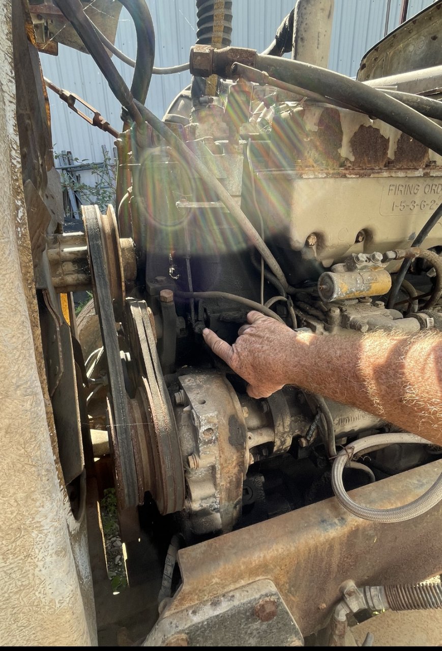

  9. OLDSKOOLERnWV
    16,016
    236,937
    If it has a compression release as @SmallPackage mentioned, it will have a pull handle in the cab. The lever on the engine will be visible on the left front….
