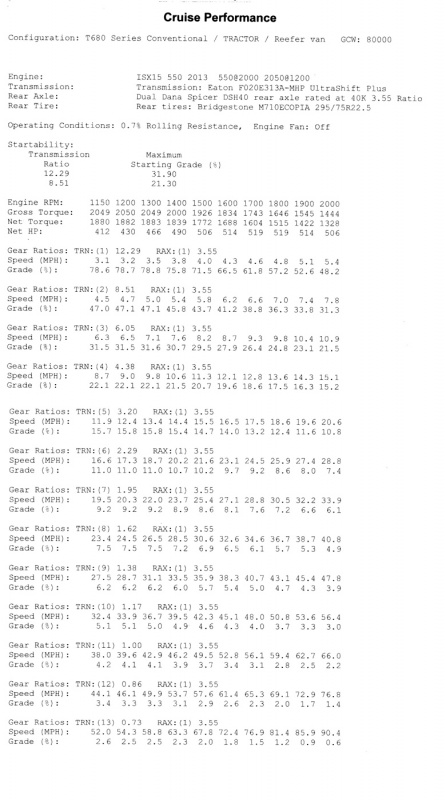

    While specing an ISX motor for my new 2014 KW T800, I got a piece of info from my local Cummins dealer for the HP/TQ graphs of the particular ratings I was interested in. Here they are for those who interested in EPA 2013/2014, CM2350 ISX Signature series with 550/2050 and 600/2050.

    Interesting that the hp graph shows almost no drop in power from 1500 rpm to redline.... Most new engines are gasping for air at those higher rpms.
    Tks for for posting it .

    Yes. It is definitely shows more with the 550 rating.

    I real life net engine power is limited by transmission ECU to more calm values.

    I have a similar printout as well from my spec with 600/18/3.91/24.5, I'll try to post it tomorrow. How do you like performance of your Ultra and 550 so far?
