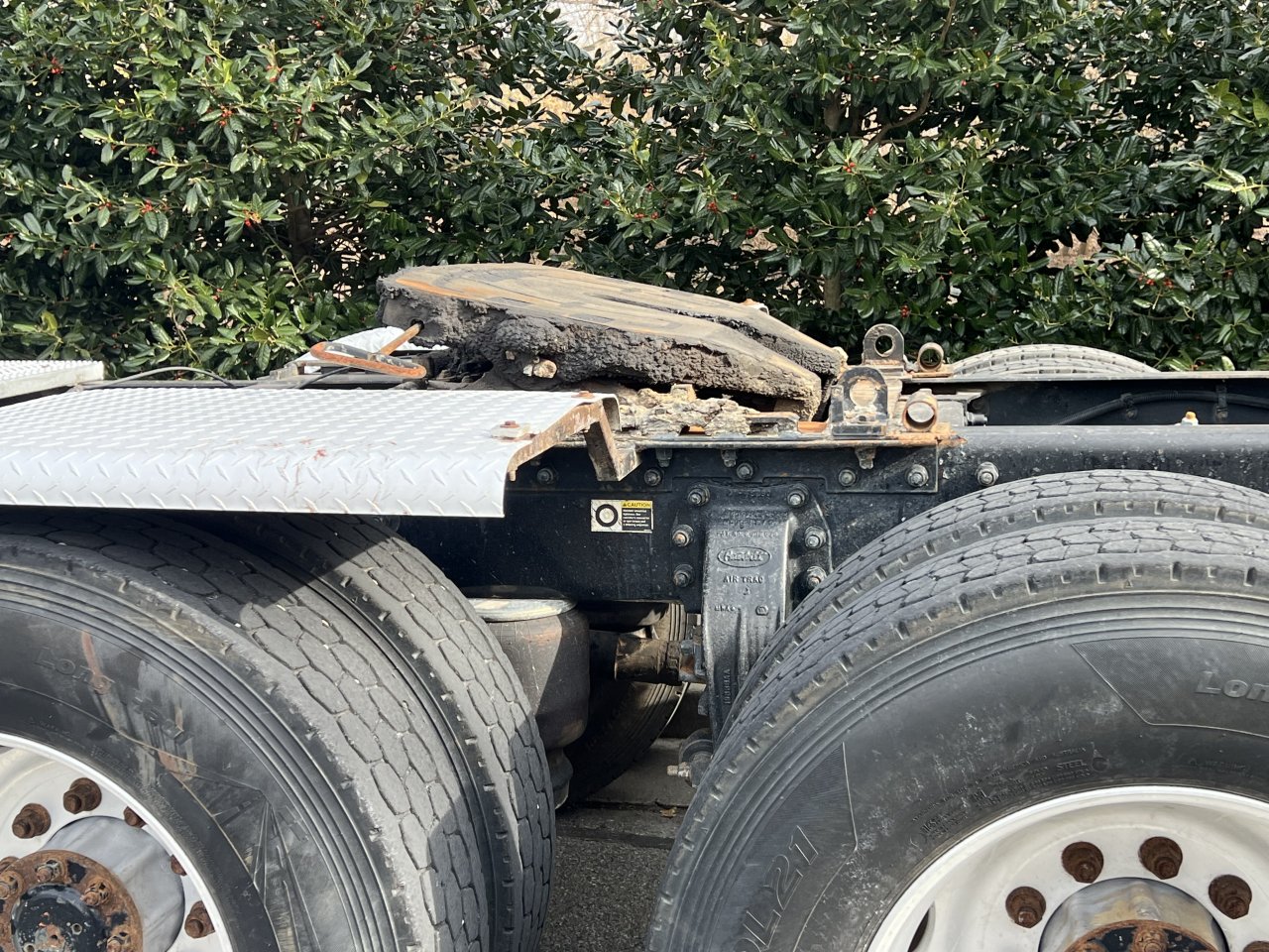

    I only want to slide it to kind get in the middle of the tandems. This is its current position. IMG_7656.jpeg
  7. Big Road Skateboard
    6,872
    38,760
    May 2, 2021
    Do you need to move it, or just want to? Is weight a concern? As nasty as that slider plate looks, it's all probably rusted together anyway.
    I'd clean that off and spray some penetrating oil around the locking pins.
    Then figure out your air issue.
    Speedy356 and Diesel Dave Thank this.

    Feb 2, 2025
    I wanted to move it I figure where it was currently would put more weight on the steer axle
    blairandgretchen Thanks this.
