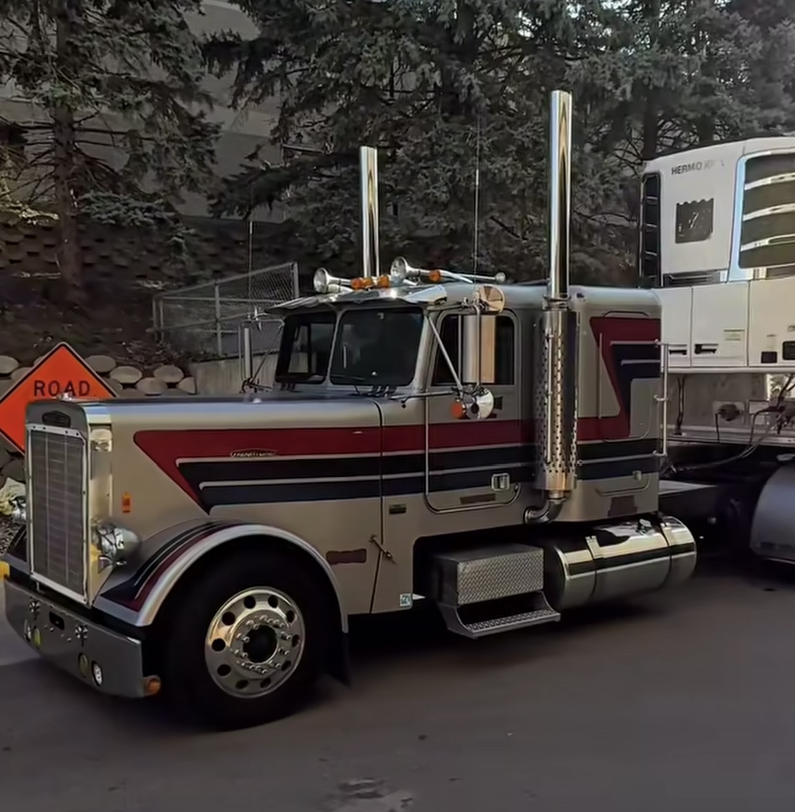

  9. Long FLD
    Long FLD Road Train Member
    12,601
    52,403
    Mar 4, 2015
    Not sure what all was done here, old looking hood on a newer cab but it’s built into an extended hood. Al-Amin out of Chicago owns it. You could track them down on social media and pick their brain.
  10. Marmon110P
    Marmon110P Light Load Member
    192
    189
    Feb 24, 2019
    Wow!! That's pretty bad to the bone!!!
