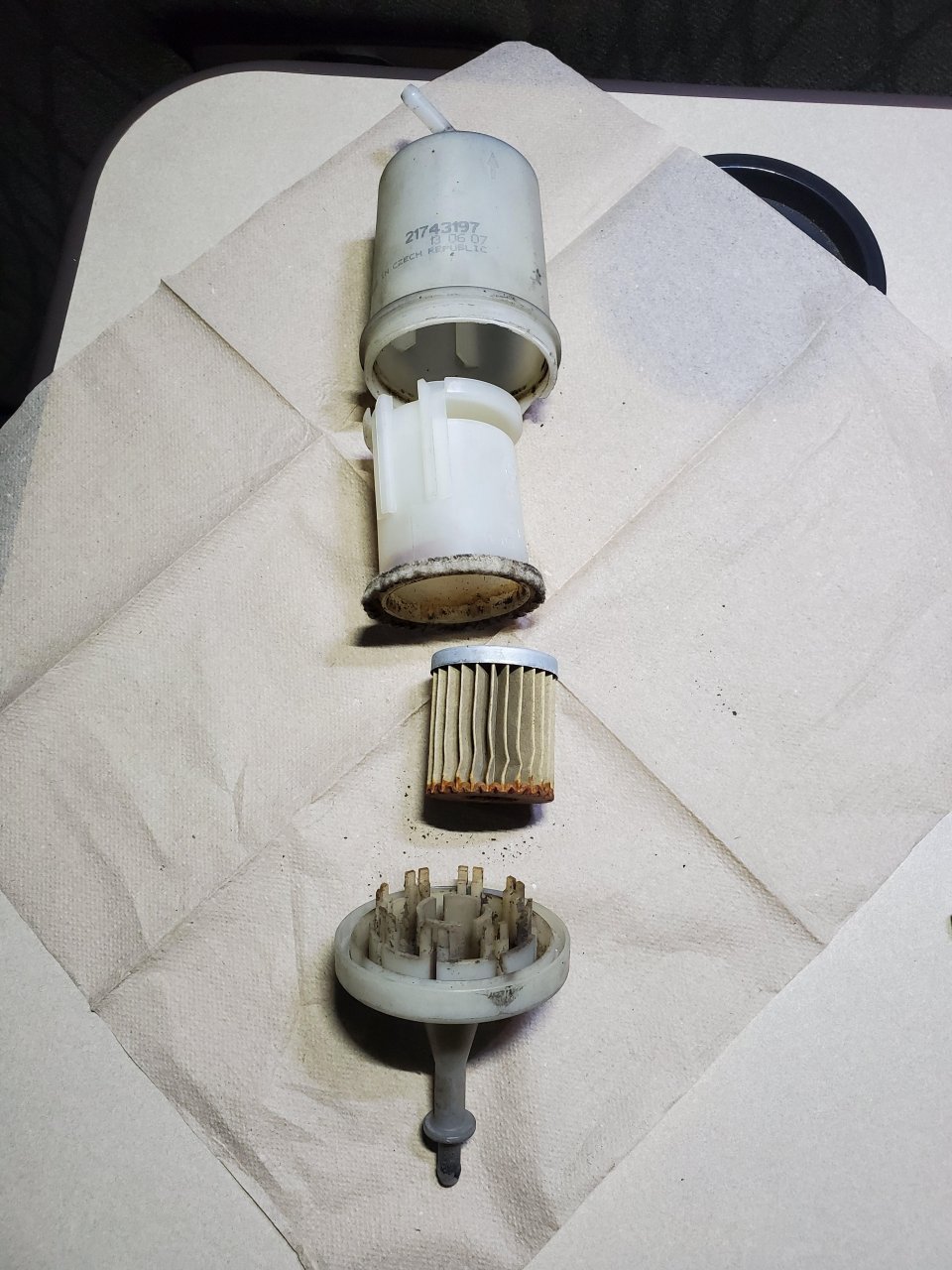

    This thread is old but I have some info that may help others.
    I have a 2014 780 with a D13. I was having the same issue. Left tank (with fuel sender) was draining but very little was draining from the right tank.
    I put in a new vent on top-about $30. Still same problem. I then blew air in with my mouth into the 1/4 inch plastic tube that runs down the side of the tank from the vent. Nothing.
    Then I used my air hose connected to the trailer gladhand and shot some good pressure into the tube put it was coming back out in my direction. So I squeezed the tube really hard and shot air in and I heard a loud pop like a very loud fire cracker.
    When I followed the tube, I ends behind a bracket mounted to the side o the tank. Held in by four 10mm bolts. When took it off, to my surprise there is an air filter there ;). The filter was so clogged that when I shot air into it, it just exploded open. I had a peterbilt for years and the tube just ran off the tank vent with no filter. I did not realize that Volvo puts air filters on the air vent tubes And they are pretty good ones too.
    Each tank has one. about 20 bucks at the dealer.
    What happens is that if you fuel alllllll the way to the top, the fuel expands and goes up the vent and into the tube then into the filter. The filter gets wet and picks up dust or even freezes in cold weather.
    Crazy, its like trying to breathe through a straw that has a filter at the end of it. Part number is visible.
