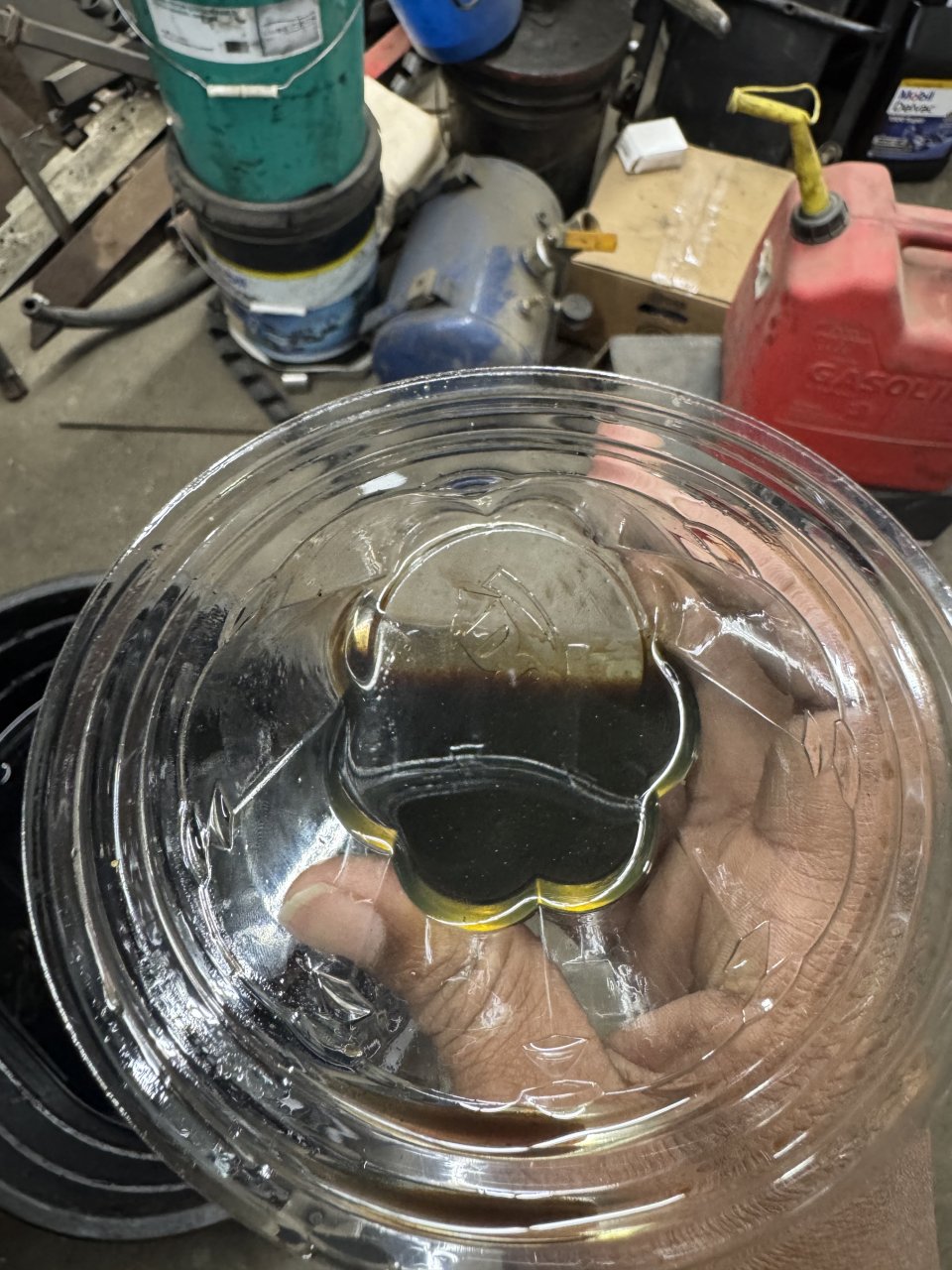

    Ok,
    Ended up being fuel pump was overheating fuel up to 150 degrees.
    It was causing asphaltine.
    NOW...
    I've done had to replace 6 injectors!!
    As soon as they're put in they are being damaged within 200 miles and most within first 40 miles.
    Fuel rail was changed and I was told there was nothing dirty between fuel pump and rail..
    I just had engine rebuilt in October and then after the fuel pump started this nightmare..I'm pretty much out of funds and resources now.Its all about but wiped me out.
    The shop is working with me on payment but I'm about to my end.
    Any knowledge,opinions,and responses are fully appreciated..
  3. TruckkinItUp
    TruckkinItUp Bobtail Member
    18
    3
    Jan 8, 2020
    Fuel pump was coming apart so it's taking out injectors now.
    All gauges are normal and has never been a engine warning light flash or come on.
    Something's just killing injectors now.
    Engine ran the best I had ever seen it before this last injector but as soon as it kills injector naturally back running rough and fuel mileage plummeting.

  6. larry2903
    larry2903 Heavy Load Member
    786
    984
    Oct 18, 2009
    On the trails
    Are you sure you’re using the correct filter? You mention the filter plugging up at different levels. Call Davco customer service, they were very helpful to me when experiencing similar filter behavior. Even though I was told by a few parts departments that I had the correct filter, Davco told me I did not. Problem was solved by them.
