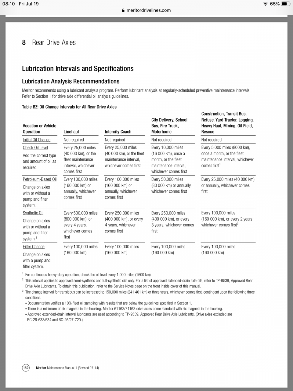

    836DA0DD-77A3-42A9-AC6B-D96FE3901946.png Looks like you are right on schedule. Says with synthetic 500,000 miles or every four years.
    biofumes, Newto Trucking and Rob100100 Thank this.
