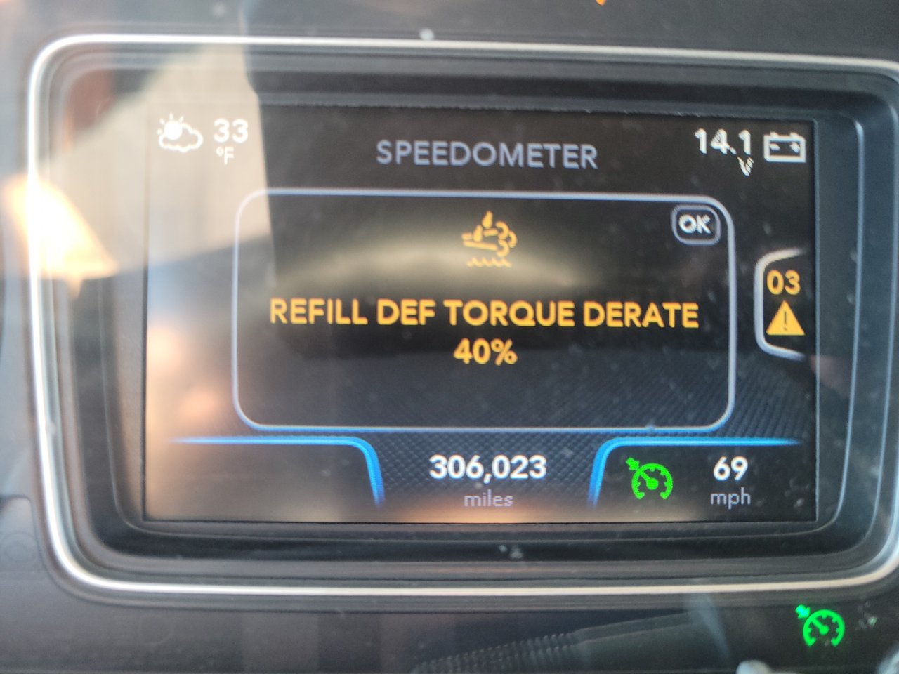

    HI guys
    This is an International 2020 - commins engine - getting these errors :
    1. REFILL DEF TORQUE DERATE
    2. SCR ERROR - TORQUE DERATE
    DEF is full - after I reset the error it will come back after a week or so,
    would appreciate your advice on this issue.
    Thanks in Advanve

    Remember also. The DEF heater valve solenoid being stuck open is the cause of the QLS failing. Change that also to prevent same failure.
