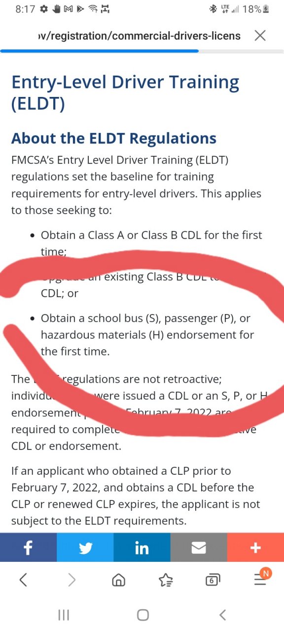

  9. Munch75
    Munch75 Light Load Member
    192
    426
    Aug 29, 2021
    The ELDT regulations are not retroactive; individuals who were issued a CDL or an S, P, or H endorsement prior to February 7, 2022 are not required to complete training for the respective CDL or endorsement.
    If an applicant who obtained a CLP prior to February 7, 2022, and obtains a CDL before the CLP or renewed CLP expires, the applicant is not subject to the ELDT requirements.""
    Bizzarrogeorge and 86scotty Thank this.
