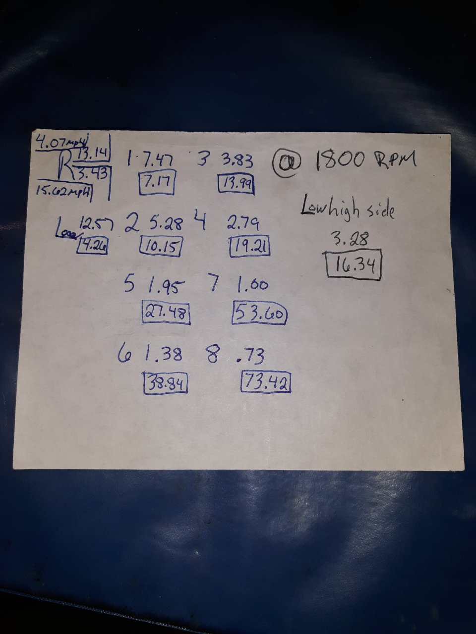

    Ok thanks alot....yes the mechanic said everything matches on the transmission side of things. And this was my first time going to this guy.
    So its ok for me to take the rpms to 1800?
    I'll review everything you've sent...thanks again...helps me look at things differently now.

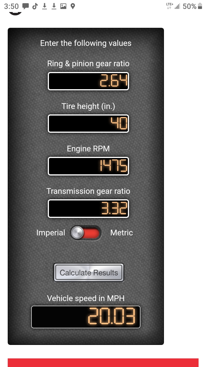

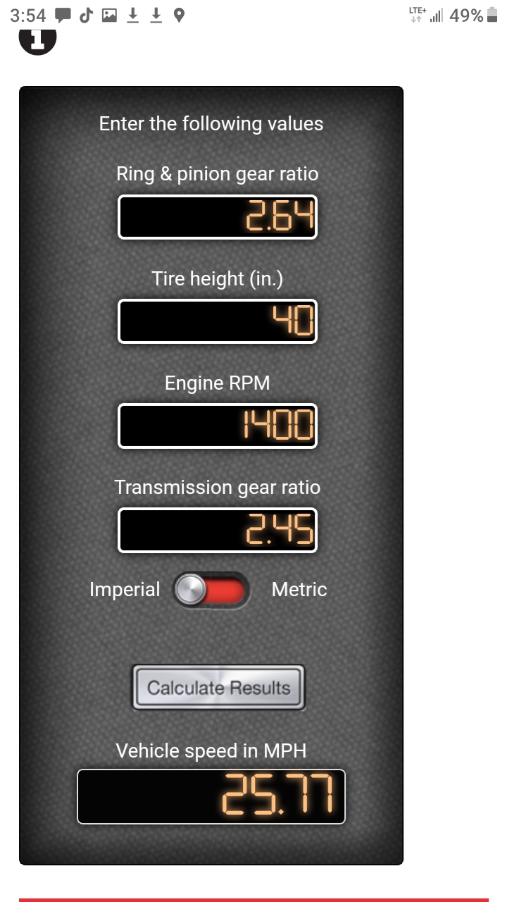

    Here, I did it for you because I was bored. Everything seems to match up with what you are saying. Just a direct drive trans in action. Probably not the best spec for running local if that what you are doing with it..
    This screen shot matches up pretty well with the 7th gear picture you posted IMO..
  5. singlescrewshaker
    4,478
    38,067
    Dec 31, 2017
    Little Havana, FL
    Math looks pretty spot on..
    Again these are all for 1500rpm
    Your 6th @ 1475rpm looks like 20mph on the
    speedo
    Your 7th @ 1400rpm looks like 25mph on the speedo
    Either your tachometer or speedometer was off at one point, or your memory has slipped on this one..
    This is all I can figure..
