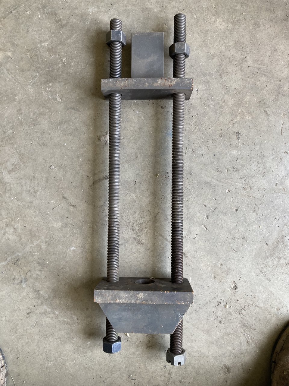

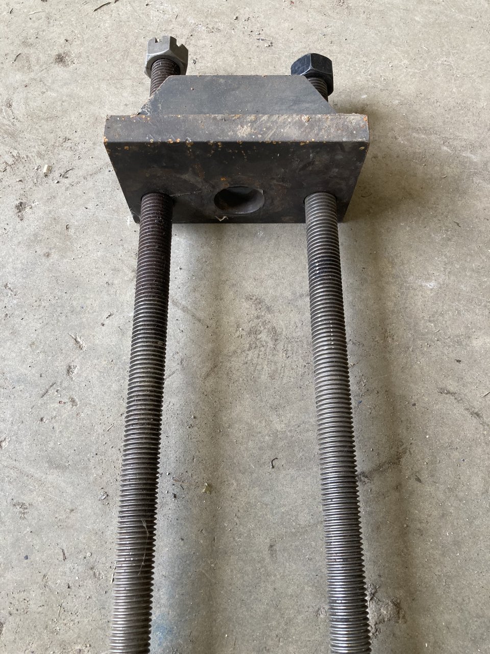

  7. W923
    W923 Road Train Member
    1,008
    3,010
    Feb 28, 2022
    This contraption fits a 30 ton porta power and has been used for spring bushings removal.
    It wouldn’t be to hard to make

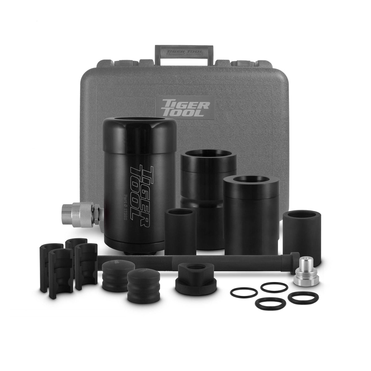

    I have done probably over 100 pin and bushing and bar pin bushing jobs front and rear with it. Not something a one truck guy would need. I know @OLDSKOOLERnWV built his own tool to do his.
