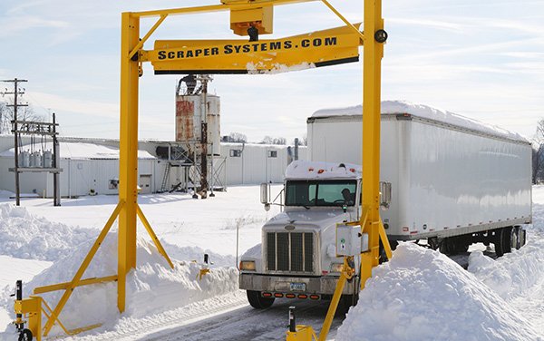

    But, that also opens up another safety issue that is largely out of our hands that some states will still cite a driver for.
    Failure to remove snow from vehicle before travel.
    Big $$ to be made there if someone could bankroll the bottom line to put the equipment in a few truckstops that adjust in height to knock it off.
    It exists.. just not widespread, nor public.
    I'm not climbing up there to do it by hand.

    Blue beacon can get rid of it. The have an overhead sprayer for deicing.

    If we knew your location we could probably direct you to the nearest scraper which would cost nothing.
    We have one in our yard.
