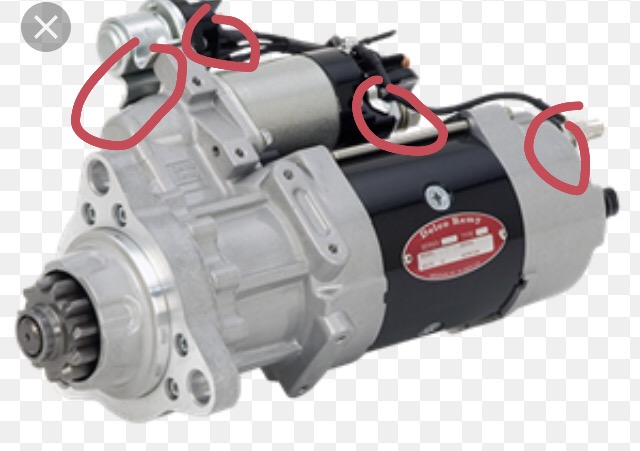

    1 screwdriver, and long lenths of copper wires.
    I helped a fellow driver out, jumpstarted his truck TWICE, at the cat scale and fuel line. (He kept forgetting not to turn off his truck).
    In the picture, I highlighted the possible areas where the current needs to be bypassed.
    Wire needs to have both ends exposed, tie one end to a screwdriver. Touch the screwdriver at one of the areas highlighted where it is easy to reach, the other end of the wire will be touching the area that is hardest to reach. (Note, not all starters are placed the same, like my truck, the starter is backwards so I would have to crawl under the truck.)
    Before you touch, turn the key off, and key on. Take the gear out of neutral. Wait for a clicking or buzzing noise. Touch the starter, THERE WILL BE SPARKS, and the engine should crank and start.

    Yup, but may not work on newest trucks.
    My last truck with a DD15 would not fire the injectors unless the ECM was sending a start signal to the starter. Although if someone hit the start key at the same time you hit the starter with the screwdriver it may work.

    In desperate scenarios where nobody is out to help, and you are in the middle of nowhere, here's what they can do.
    1. Disconnect the batteries, and make sure the truck has no power
    2. Wire up the starter, 2 separate cross wires incase one of the wires get burnt. (Look at the pic that I put up to see where to tie the wires).
    3. Stand outside. Start connecting the batteries, before you connect the last one, get ready to turn the key and crank it. You have a 5 second window.
    4. If your battery box is on the passenger side, and the starter is on the driver side engine, then you are f*****

    That's fine as long as the issue is not in the solenoid or shift lever causing the gear shaft to not engage the fly wheel.
