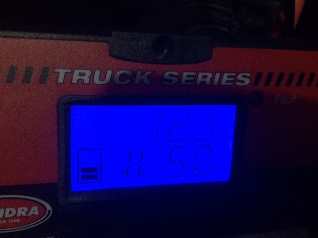

  4. gpf87
    gpf87 Heavy Load Member
    765
    880
    Feb 2, 2017
    This is on a newer freightliner with the standard 4 battery setup ; The batteries themselves are over a year old and this is after 7 hours of sitting with a fridge,direct tv receiver,and small lcd tv running .
    My truck also has an apu that automatically comes on if the battery voltage gets too low
    Im not sure what an xbox sucks though , I know they have a gpu which can get power hungry
