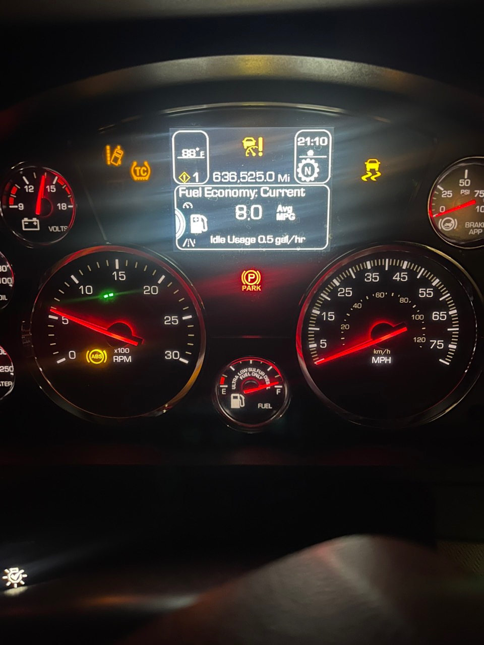

    Hello folks! Does anyone have the same situation where three signal lights: ABS , TC, and traction lights, are ON simultaneously whenever RAINING? I thought the problem was from my windshield, and rain made water leak somewhere; I replaced it already. But just today, it happened again that when the rain came15mins, all the lights were ON. What should I do? The rainy season is coming, and I need advice. Thank you. E5C120A1-9B8F-43DA-B566-E438831BE8B4.jpeg

    I had water leaking into a connector for one of my ABS wheel sensors. Acted up when wet, would clear up several hours after things dried out again.
    The fault code should tell you which one it is. Then just have to follow the wire from the wheel end to find the connector or if the insulation has a hole worn through it.
    The traction control relies on the ABS sensors to monitor for wheel spin.

    I thought about the electric link and sensor too. I’ll check it out and back to you for the answer. Thank you so much
